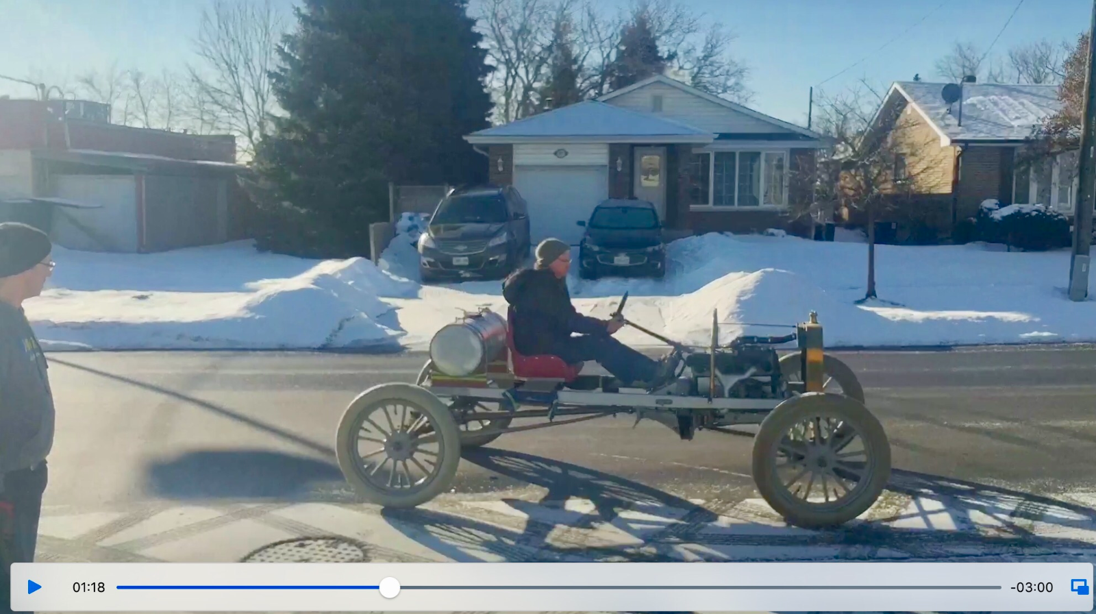

Latest update on the Ford Special racer: another drive
Peter and his group are sorting out the racer, this time cranking by hand and scooting up the street. If you watch the slowed down later portion of the clip you can see and hear the difference as Alan closes the auxiliary exhaust ports after the motor starts.
Click on the link below to see the video:
https://www.dropbox.com/s/2fnwqaugb6orx ... M.mov?dl=0

Wow! He certainly did "scoot up the street." Fun, Fun!

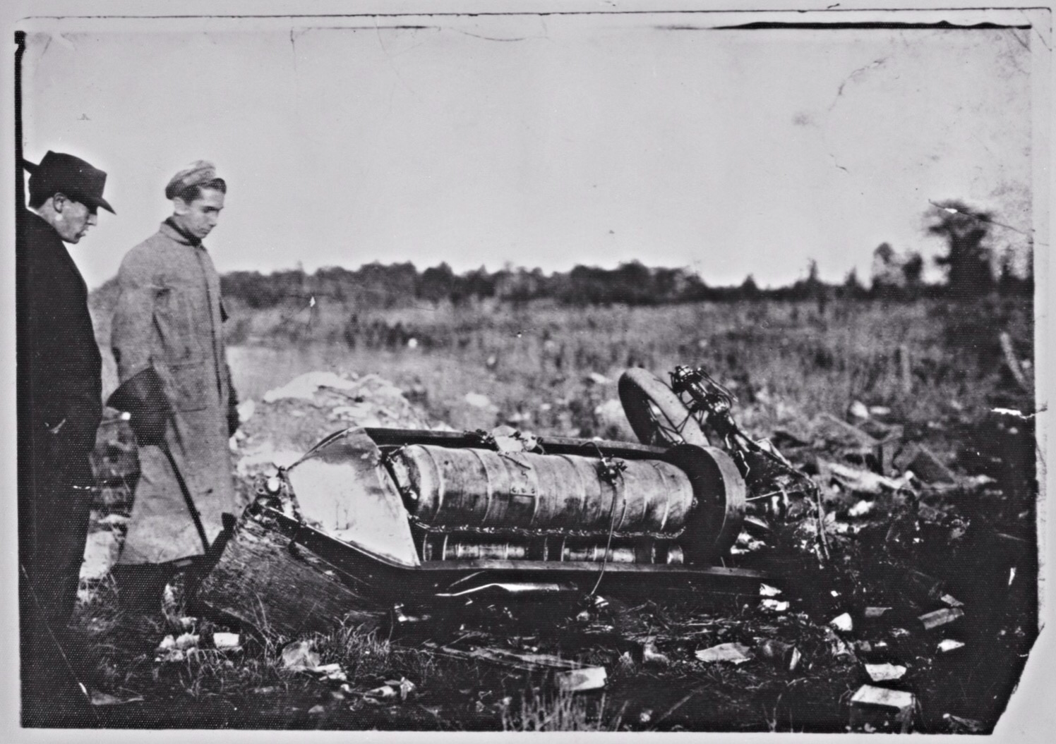

However, by early October, Frank Kulick was back at the wheel. This time with sanction and timers in place:
This time, Kulick was permanent injured, and wore a leg brace and walked with a limp the rest of his life. In both cases, I suspect he wouldn't have lived if he had "rode it out" with a lap belt. I think these machines disentegrated in severe wrecks, and the best outcome was being thrown clear of the wreckage.
Photo following the second wreck:

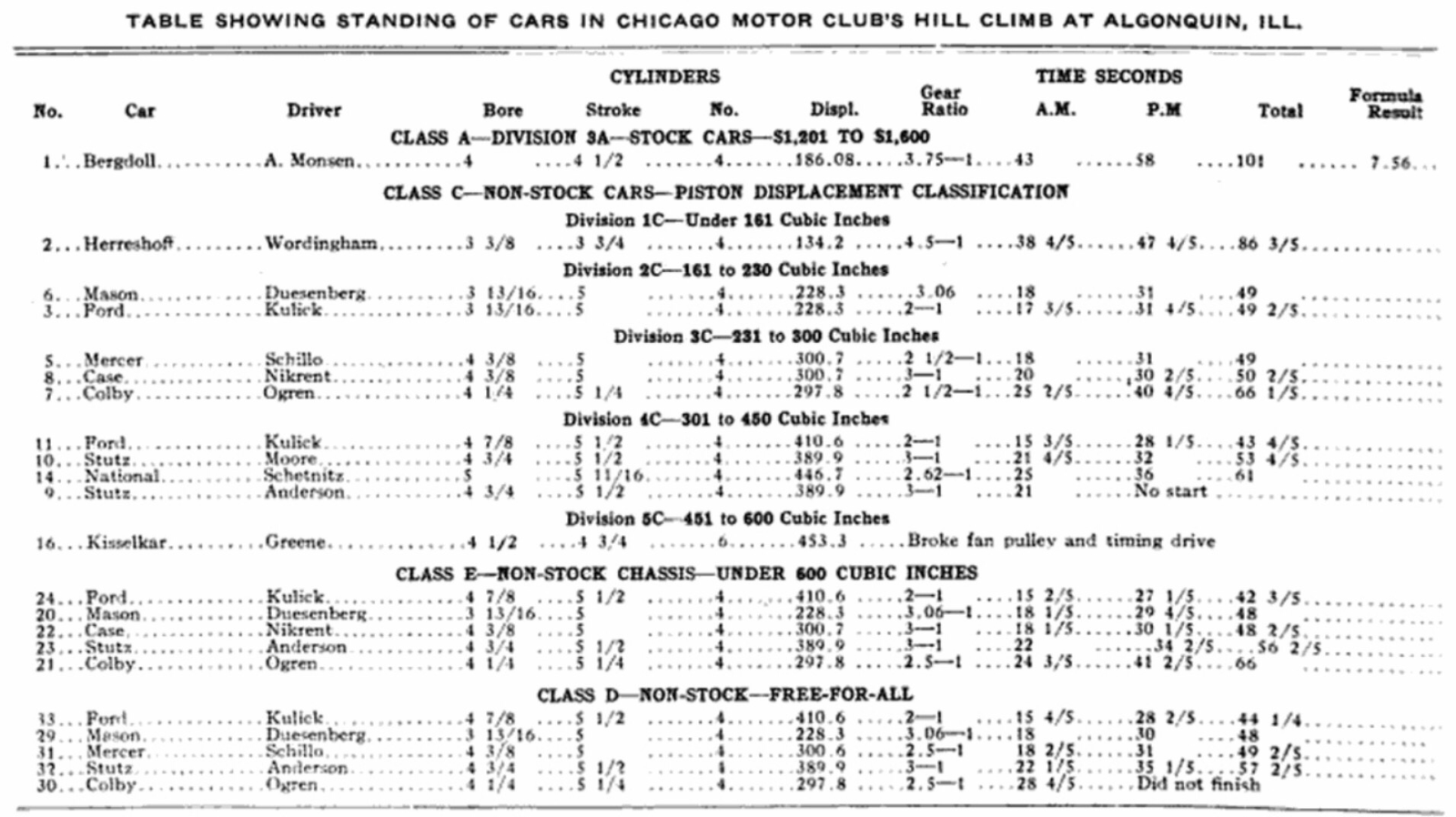

Rob
Step back to 1911. The Algonquin hill climb appears to be June 8th. Three days later there were races at the Hawthorne (Downs) race track in Chicago. Joe Jagersberger won the big race on the 11th. There might be mention of the Ford Racers at that track as well.

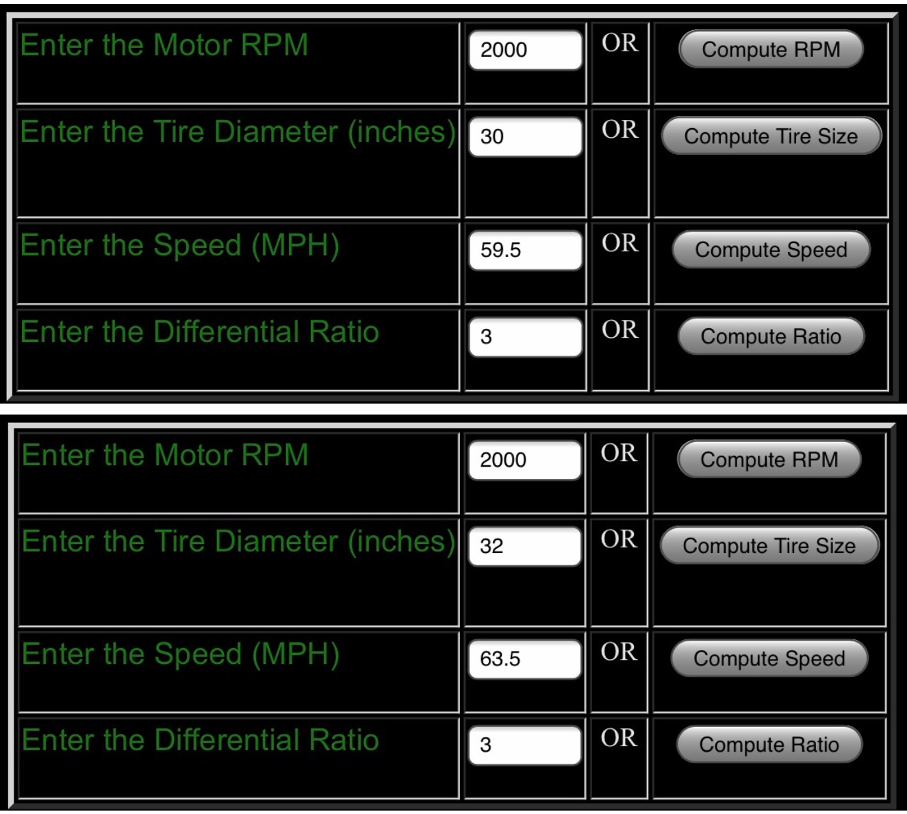

Re: Latest update on the Ford Special racer: another drive
Dave, at some point I'll try to make a list of known Ford Special appearances including location, classification, date and results.
Thanks for the info Wayne. I know on at least two occasions Henry Ford or Frank Kulick commented after a race with the six cylinder racer that the motor was running good, but the car was geared incorrectly. Many of the Ford Special race pictures that survive show the racers with wire wheels. The wire wheel drawings for M-III (300 cu. in. motor) show a 32x4 tire. That would have given a quick change step up in gears to change out from 30 to 32 inch tire.
According to this online calculator, at 2,000 rpm, a car with 3;1 diff will go 4 mph faster with the two inch increase to 32 inch wheel/tire:
