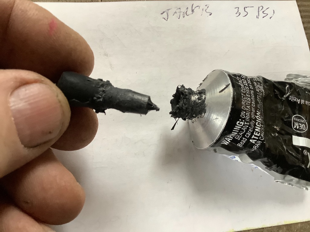

Post by Steve Jelf » Fri Feb 26, 2021 3:54 pm
When a sealant (Ultra Black, RTV, etc) comes in large and small sizes, from now on I'll get the small size. If I buy a large size and use only part of it, the remainder will be useless by the time I need it. If you infer from this that I just tried to use a previously opened large tube, you're right. :)
