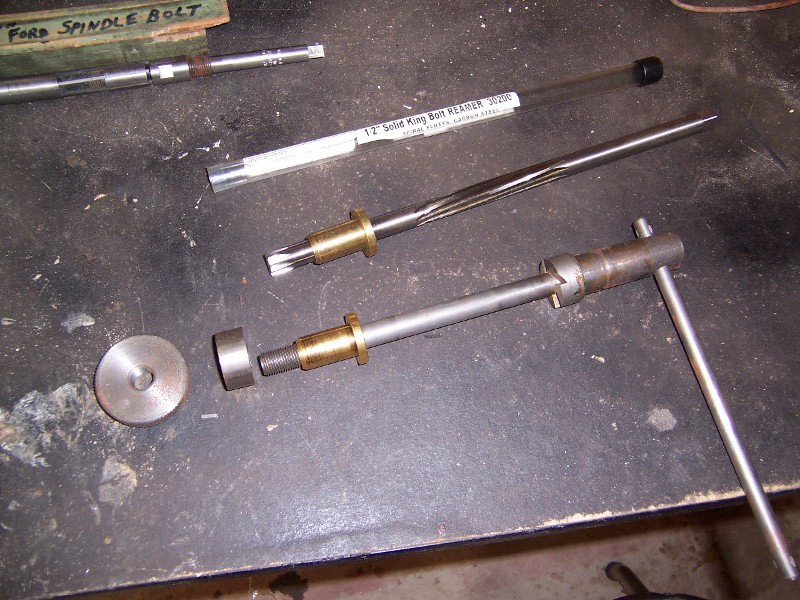

Re: How to ream spindle bushings?
By the time you have beat the old bushings out, they are out of shape both I.D and O.D, most times I use a tap and drive it in the old bushing and then punch it out. Useless as a guide.
Best to have the nice 'step' long reamer. Place both new bushings in the spindle. Then start the 'short' or pilot end of the reamer, that end is just slightly undersized and goes into one bushing easy, then the reamer drives on down and the step goes into the lower bushing. Now your long reamer is aligned and then finish driving the reamer into and out both bushings, works great.
Then face off each bushing for the snug fit to the axle yoke, being sure you have a nice flat surface on each yoke face for the bushing to glide on.

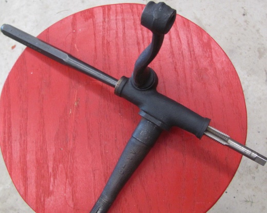

Dan- I don't think Sunnen offers a mandrel long enough and small enough to tandem hone the spindle bushings. The smallest diameter P20 mandrel long enough is for a 5/8" bore. Is there a smaller one that I'm not aware of? Hope so! For everyone- the tap method that Dan is showing is by far the easiest way to remove old bushings. If you don't have a tap, you can split the bushing with a hacksaw blade, then collapse the bushing by grabbing the flange in a vise and crushing it, but the tap is the best way I've found. Dan Mc
