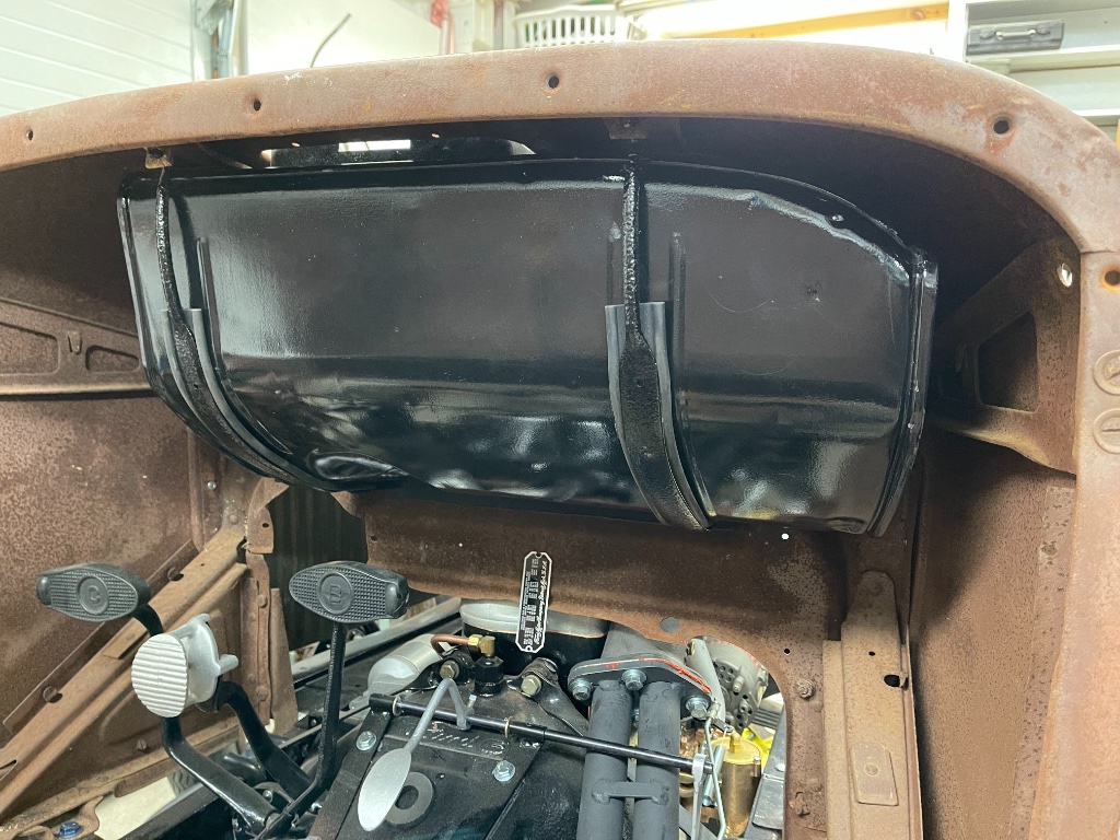

I just installed mine and the top of the tank rests against two braces with webbing straps between. The height is determined by how thick the webbing is and how neat a job you did getting the webbing between the ribs on the braces. I did not take the time to cut the webbing as it is a little wide as it comes from the vendors. No big deal as mine sits about 1/16 low.

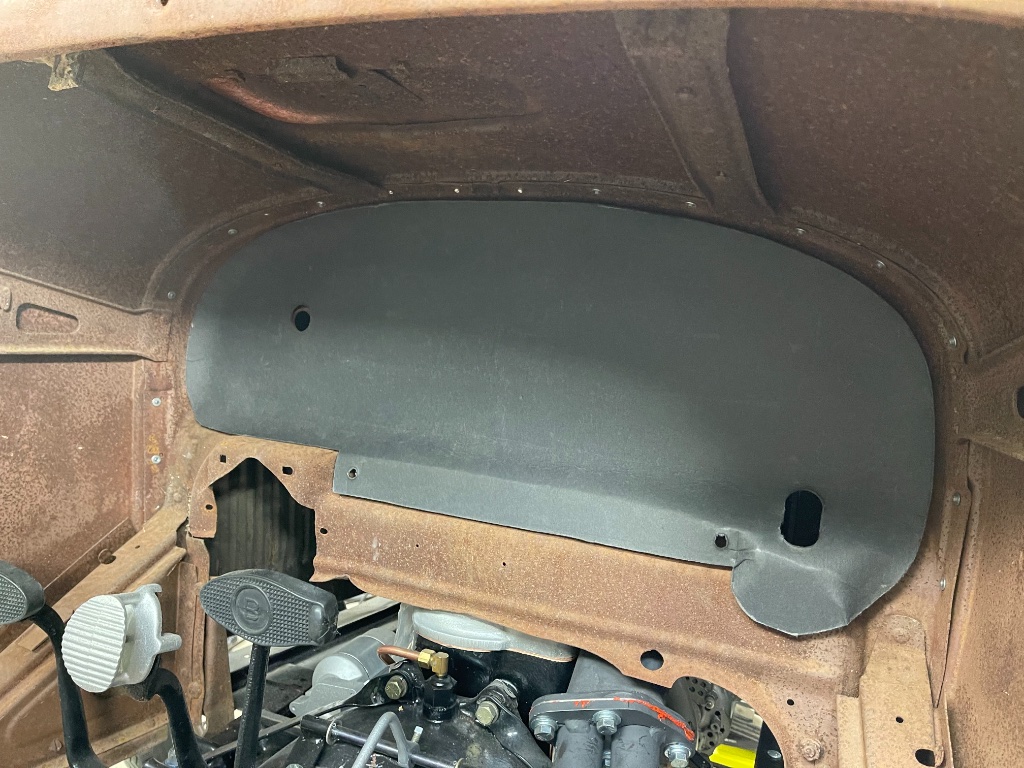

Also thrown in the mess is if you have the 27 model full cardboard pad that sits between the tank and firewall. This has some effect on how the tank sits . 26 has 2 webbing straps.
