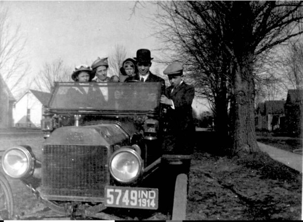

Post by Herb Iffrig » Wed Mar 03, 2021 10:38 pm
Notice the headlights.

Looks like a 1913

I think they're normal pre-1915 gas headlights, aren't they?

Looks to me like reflector and globe.

The forward folding top windscreen is usually associated with 1913 models. The headlights look like Brown lights, fitted with full reflectors and globes.
But the cation does not lie. The car has 1914 tags.

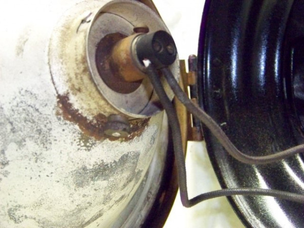

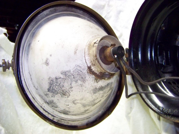

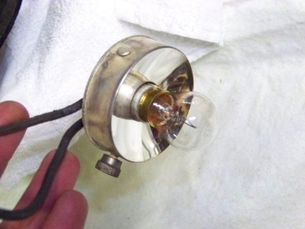

Hi Steve and Kerry. I think that both of you are right.
If we look carefully at the headlamps, the top of the smoke bonnet can just barely be seen behind the headlamp rim/ headlamp door. These ARE gas lamps.
There is no gas burner to be seen and no Mangin mirror either as they have been replaced with one of the aftermarket kits available at that time.
These kits provided you with silvered reflectors, bulbs, wire, and a switch to convert your lamps from gas to electricity. Also note the position of the lad standing on the running board at the driver's side. He is standing just about where the gas generator would be mounted, suggesting that it has been removed as it is no longer needed by the now electrically powered lamps.
The advertisement for the "Improved Lighting Outfit" shows the kit which is my '14 touring and was likely installed by the original owner of the car, along with a few other period accessories to make touring more pleasurable.
The Improved kit permits the bulb to be accessed from the rear of the reflector, for replacement when necessary. The lower cost units require that the reflector be removed from the headlamp door/rim to access the bulb from the front, which is inconvenient at best and risks dropping and breaking the lens.

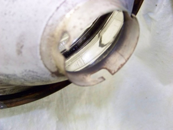

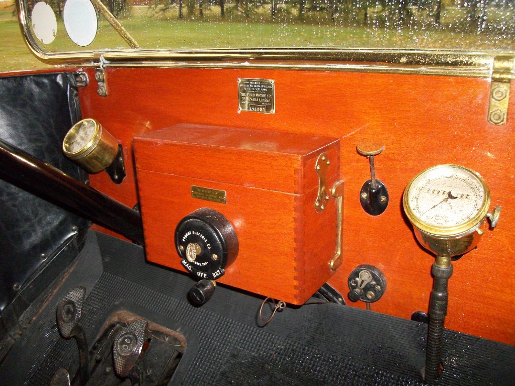

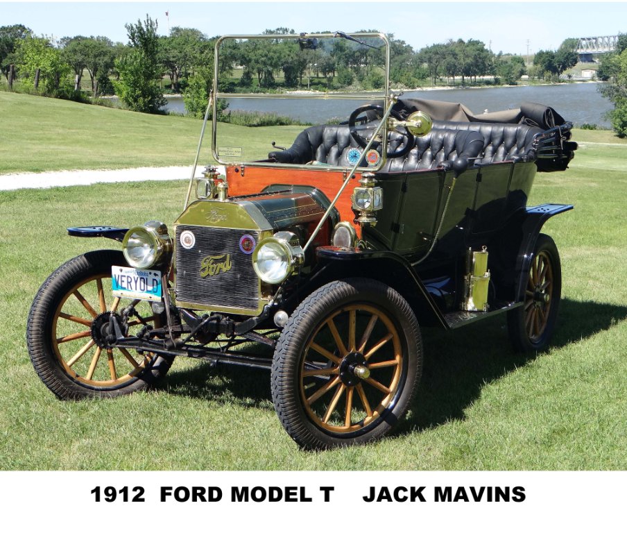

My 1912 has had Mag lights since 1915 installed by Dr Bond at a cost of $3.25 . The reflector clips into the original lamp rim,the burner is removed to allow clearance.
