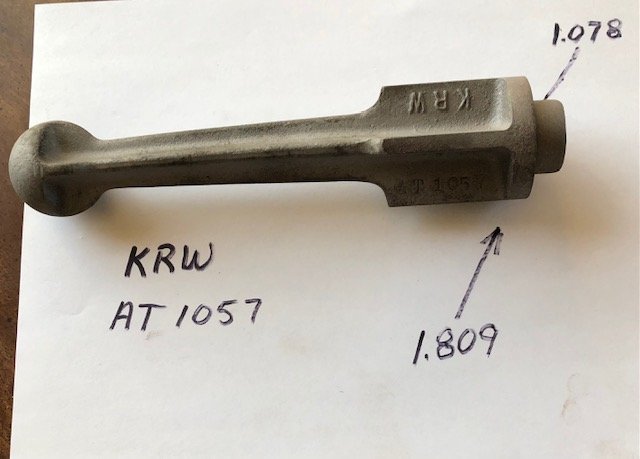

i have several KRW tools that i have "dug out" of my archives ... some are of known use ... most are spoken for ... i am wondering about tool # AT1057 ... this seems to be a seal driver ? i have included a picture with dimensions ... any help in identifying is appreciated ...always an optimist ...Gene French

Gene for a model A. Look up KRW tools, there is a web site that will help you id the tools . Dan

Without the book in hand, I am pretty sure that it is for installing the upper drive shaft seal. That seal is knocked out from the rear and installed from the front. They came in two sizes, car (this one) and double A truck. There would have been a 2ed tool for installing the sleeve (again two sizes).

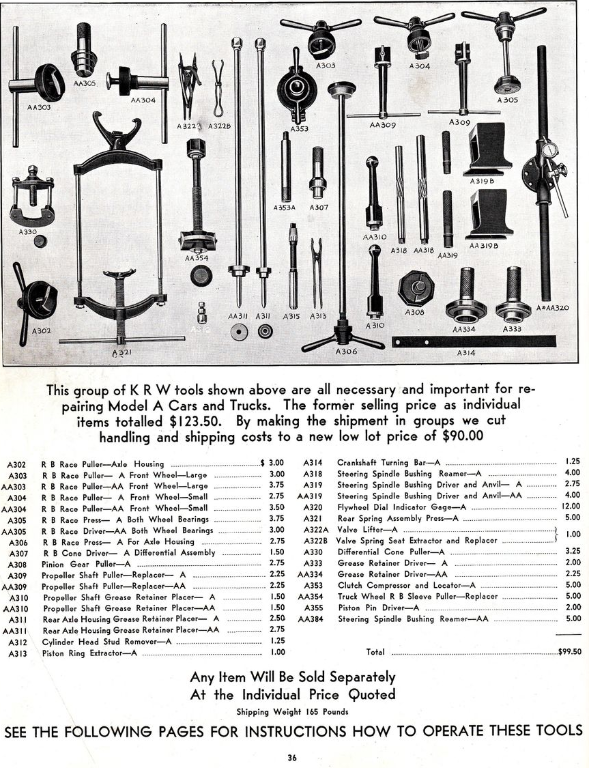

Looks like A310/AA310 in the catalog page. Described ass "Propeller Shaft Grease Retainer Placer". Likely the A and AA prefix for for the Model vehicle
Also found this site which has an entire catalogue (also they have for l ater years)
