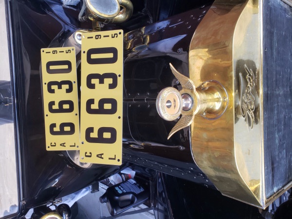

I had these made from scratch by a local sign shop using my damaged original pair as a guide.
They are the same size just positioned one behind the other.

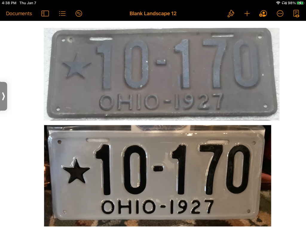

I used Larry Scott a few times. I noticed he was on the list that Dan posted. Larry does have a "real" job so if you are looking for a two day turn, not going to happen. He is in Denver, but I mail my plates to him even though I'm only about 30 miles away. Reasonable. Priced on how much work he needs to do. I sand blast mine before sending, helps with the cost.
Before
After
I assume he does plates from all states
Good Luck Steve,
Before
After
Good Luck Steve,
