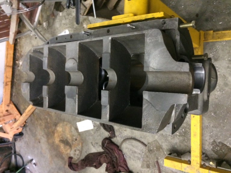

Crank side of girdle

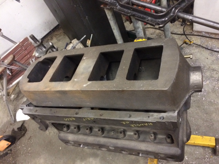

Girdle as it would be installed

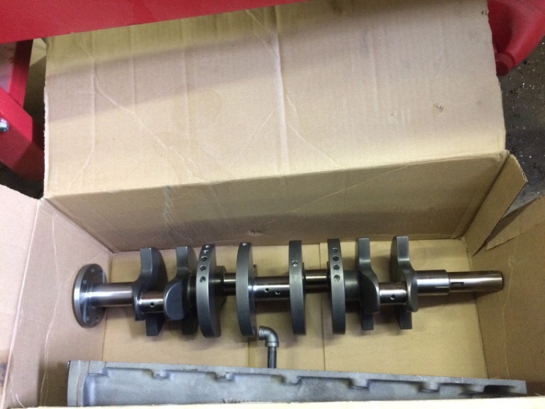

A suitable crank

That’s really cool Les definitely interested. I think I understand where you’re going with that. Does it take a special pan?

It will fit into a ordinary pan. Pressure oiled

The crank you see was custom made by Crower. I’m sure they still have the drawings!! Definitely more than a Scat crank!

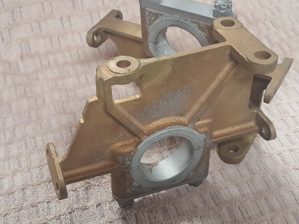

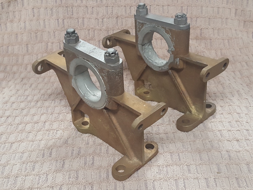

To answer your original question......Here is how it was done back then. Since they interfere with a camshaft in the cylinder block these were intended to only be used under a overhead cam setup.

Waaaaay to cool Layden!! 😳

I love it!!

If one like the picture I posted would be suitable, then Crower can help you. 4 months ago I possibly could have, but I have put it to use!

Thanks Layden exactly what I was looking for.
