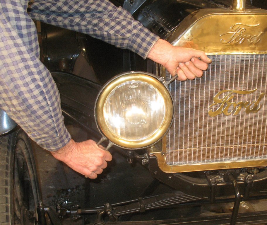

I made this tool. It comes apart at the hinge and rides under the seat. I lined it with Gorilla tape.

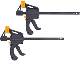

Never heard of a squeeze clamp. Don't think Google has either.

DickC
Topic author - Posts: 270
- Joined: Mon Jan 07, 2019 7:51 am
- First Name: Dick
- Last Name: Cruickshank
- * REQUIRED* Type and Year of Model Ts owned: 1912 Depot Hack, 1916 Touring
- Location: Angier NC
Re: Ageold problem of headlight rim removal solved.
DHORT--I am a woodworker and we have secrete tools we use in our business. If you want to see what I used as a clamp, GOOGLE woodworkers squeeze clamp. There are about 100 different brands and sizes. I used an 18 inch bar size. Dick C.

It looks like the one Steve made should work very well!

DickC,
Could you post a picture of the "squeeze clamp" you use? I have a lot of woodworking clamps but I'm not familiar with that name for them.

is this what you mean?
