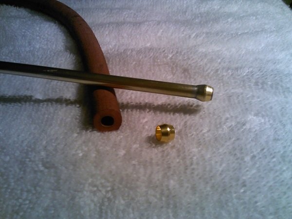

Mike, There were no hose clamps. The tubing had a small "swell" near the end; you can duplicate it by soldering a ferrule (from a compression fitting) onto the tube. FYI, I have no clamps or ferrules on mine, and soft "gum" hose does not leak. Stiffer hose would benifit from having a ferrule.

Definitely no clamps. Original tubes had a "bubble flare" like end. Not exactly a bubble flare, but close. I have an original 13 and 14 radiator that still has the original T and tubing if you need a pic.

The last acetylene lines I made have a double flare like the original. I have an original long line that shows this clearly. Yes, there were no hose clamps.

You can make a bubble flare with a standard flaring tool, just skip the last part about putting the cone onto the bubble and folding the flare back onto itself. Be sure to clamp the flaring tool body tightly in a bench vise, it's hard to tighten the thumbscrews on the tool tightly enough to keep the tubing from sliding in the tool.

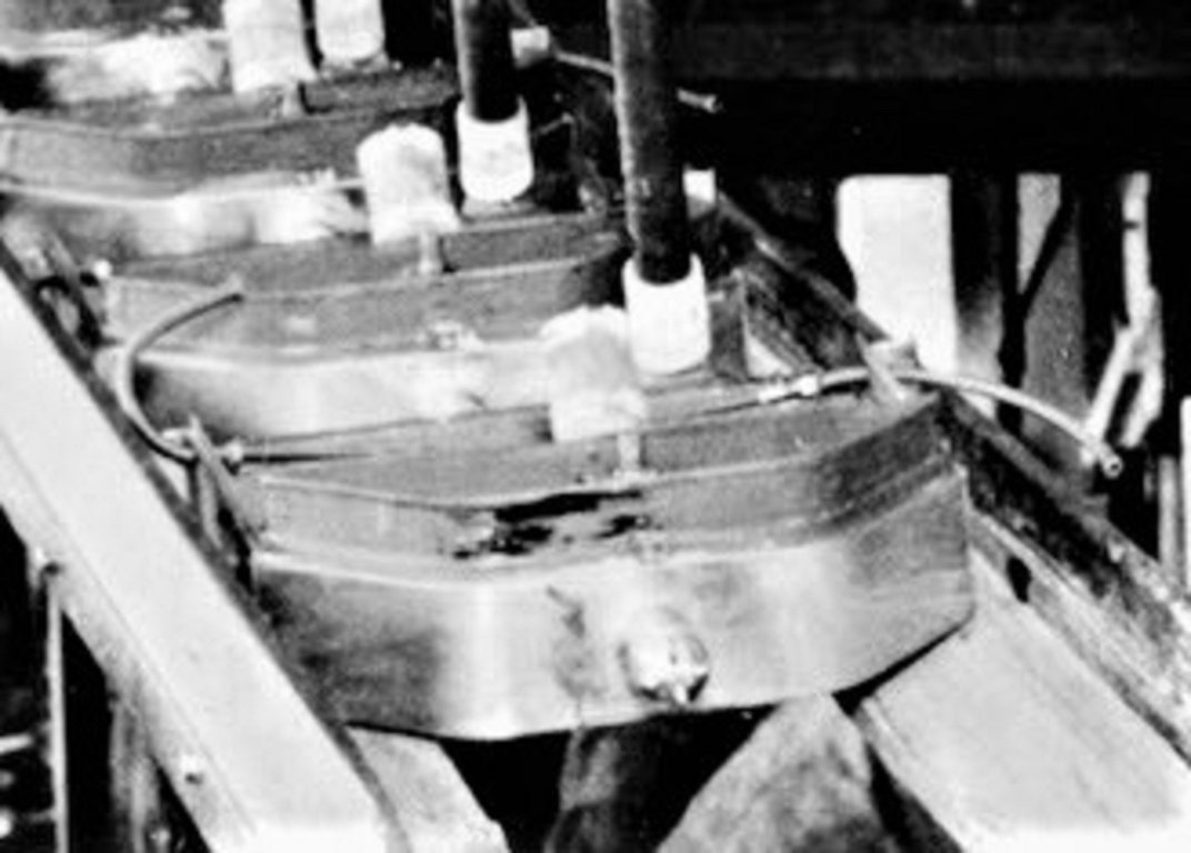

Close up.......
