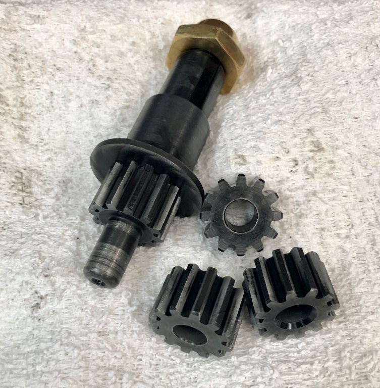

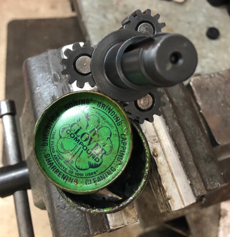

Post by DanTreace » Wed Mar 10, 2021 11:36 am
If you purchased the ''oversize" set with the oversize pinion shaft, then yes, you'll have to fit the new pinion to the cover. Either ream the cover bore or remove some of the oversize shaft to make a nice slip fit.
For me, most times the new set in std. size works OK with a cover that has been re-plated with nickel, as the new nickel layer adds just the right amount of thickness to a worn bore in a cover.
Also, I like to 'lap' the new gears to the new pinion too, for smooth operation.
