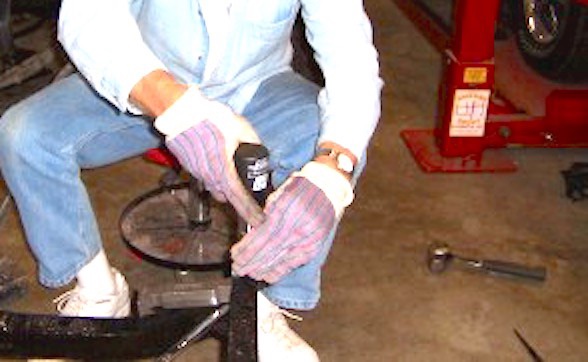

If you have use of an oxy/acetylene torch? Rivets can be done hot. Rivets can also be done cold. There are advantages to either one, and debates still rage on about which is better. My point is, that even without a torch, riveting can be done by almost anybody, especially with a little help.
I usually have to work alone. Such is life. I use a chunk of heavy scrap iron and C-clamps to buck rivet heads. I find it makes it a one-man-job pretty well. I usually do chassis rivets hot, but have several times done them cold that way.

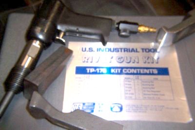

As others, re-rivet is an easy task with good tools, cold rivet uses just a good buck at the back side, and if you want to form a nice head, a tool, and a large mallet. Really no substitute for a tight solid rivet, threaded bolts can wear at the threaded shank, with the twisting of a Ford frame, and get loose over time. For hot rivet, a torch is best, heat the rivet and insert, then buck the backside and a pneumatic air tool rivet gun is really handy.
Have done several frame parts with the gun, alone or with a buddy helper, as that is best.

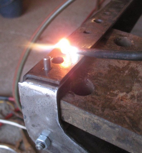

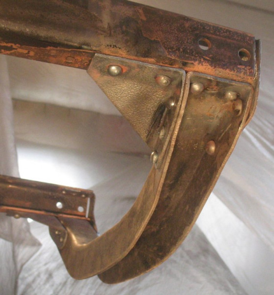

The '15 frame has the running board brackets riveted. In this photo, a partial and poor '15 frame is used as template to drill holes in a later frame to mount the forged running board brackets. Hot rivets used in this one.
Rivet gun
Rivet gun

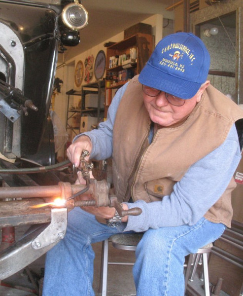

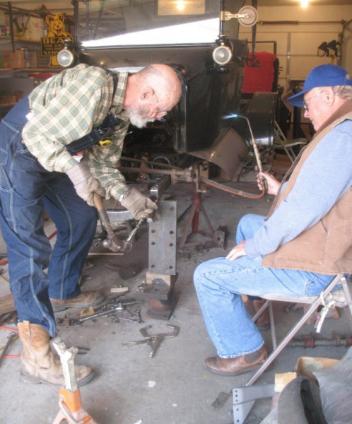

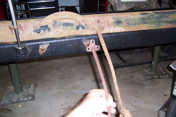

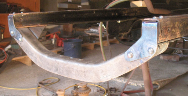

I had to replace the front cross member in my 1915. Here are some photos.
I bolted in the new piece to keep the holes lined up and replaced the bolts with rivets one or two at a time. I found it most convenient to install a rivet, back it up, and heat it in place.
My neighbor kept the rivets hot and I mashed them.
The awkward part was getting the backup weight in place and clamping it to stay.
I found it most convenient to rivet the brackets on the cross member out of the car and install them together.
I think we did a pretty good job for a couple of novices.
