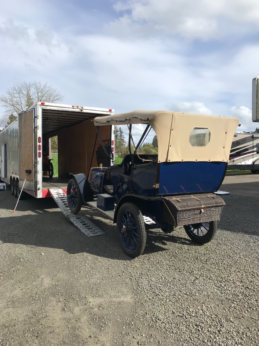

Hello Tim,
If you are going to be hauling a Model T Touring car in an enclosed trailer with the top up - allow for a minimum 7 ft. 3 inch rear door clearance.

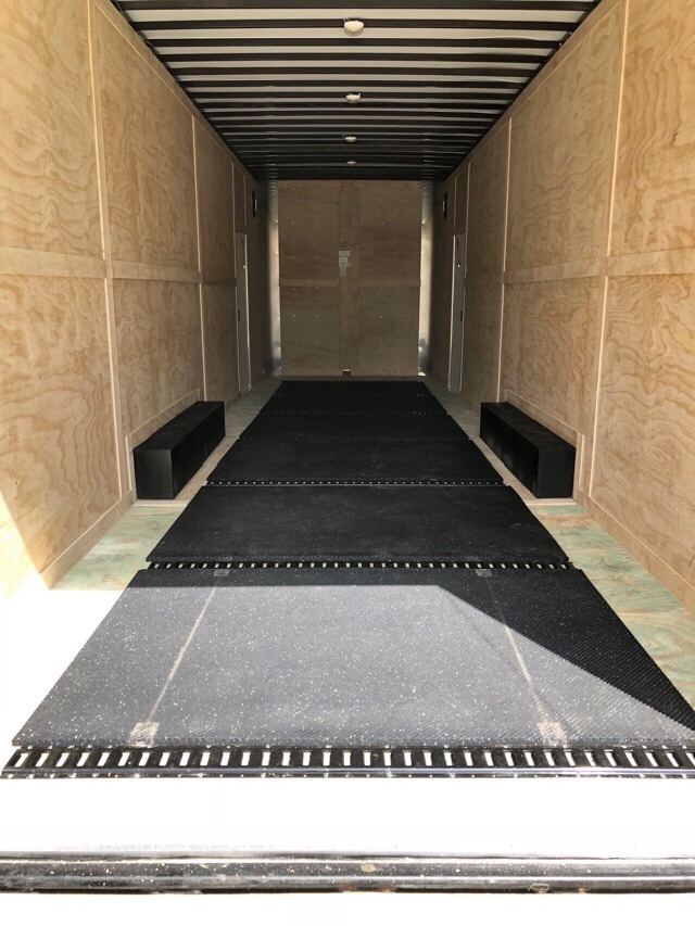

My latest enclosed car hauled design has surface mount etrac installed width wise about every (4) feet with recycled rubber 4 ft. X 6 ft. horse stall mats
installed between the etrac.

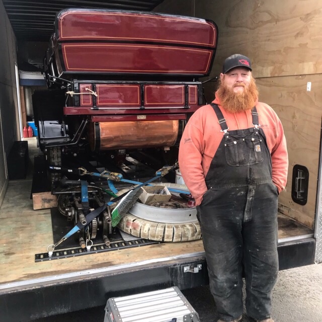

Regarding tie downs ....
I buy Mac’s axle straps in a variety of lengths
from Summit Racing along with Mac’s fleece
velcro sleeves that attach over the straps and
can be removed for washing.
Here is an application on a 1915 Stanley Steamer
12 Passenger Mountain Wagon with a cross pattern
to minimize vehicle shift inside the trailer.
Some folks go to the wheels - some go to the frame - some go to the axle - there is more than one way to secure your vehicle.
I have been transporting earlier cars for fellow HCCA members the last few years so I always ask them what works best for them.
I am now doing a minimum (4) to (6) point tie down
on all early cars and pulling towards the center to minimize stress on the frame and body.
FJ
FJ
