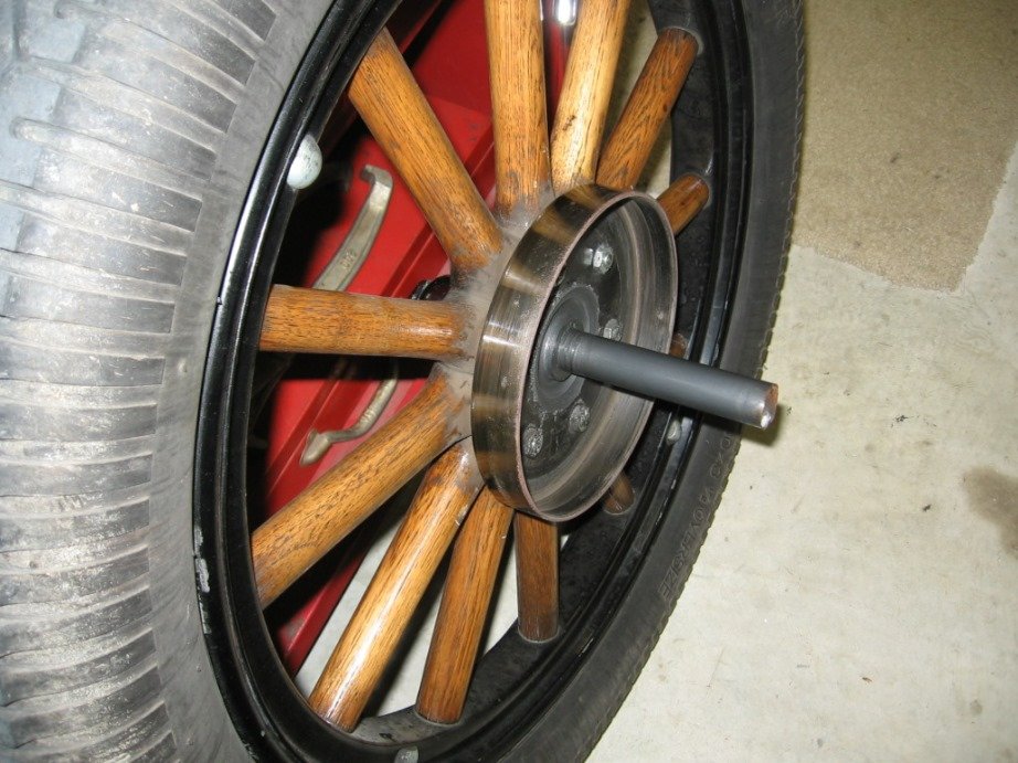

Does anyone have any experience with fitting these to the rear side shafts. I would like to know of the side / half shafts need any machining to make this bearing fit.

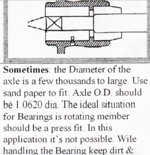

2508X is Snyders part number for the same Langs offering, it's made in Texas, a very short modern outer bearing with Timken taper fitted to shell race that has to be pinned to the axle housing, by using that existing hole in the outer housing that holds the Hyatt sleeve dimple, and using a 1/4” dia. set screw. Supposed to replace the long flexible ribbon roller Hyatt bearing used by Ford.
Instructions says it will slip on, but maybe if axle is old worn, if new (factory spec is 1.062-1.065”), likely you have to remove a bit to slip it in place.

In viewing the above image, does anyone think the “new, better bearing” is a bit shadetree? The instruction even says it isn’t an ideal fit...
Picture an original axle shaft being a light slip fit to loose fit in the inner bearing race of that modern bearing. The axle shaft is now “rolling” on two thin hardened races that are likely much harder than the Rockwell C 50 hardness of a Ford/proper axle shaft. And unless this entire assembly is set up to be greased by the rear grease cups, then the interface between axle shaft & race now is absolutely dry. I would anticipate a much more rapid work hardening and potential failure of the axle shaft versus the “original” setup.

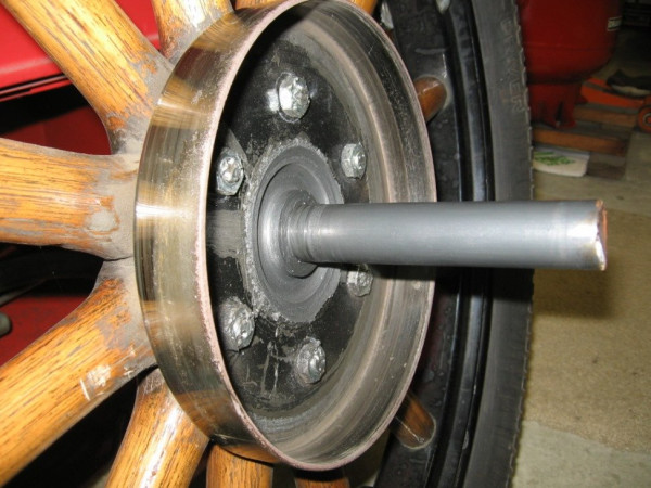

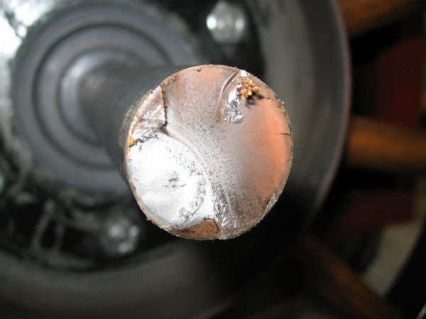

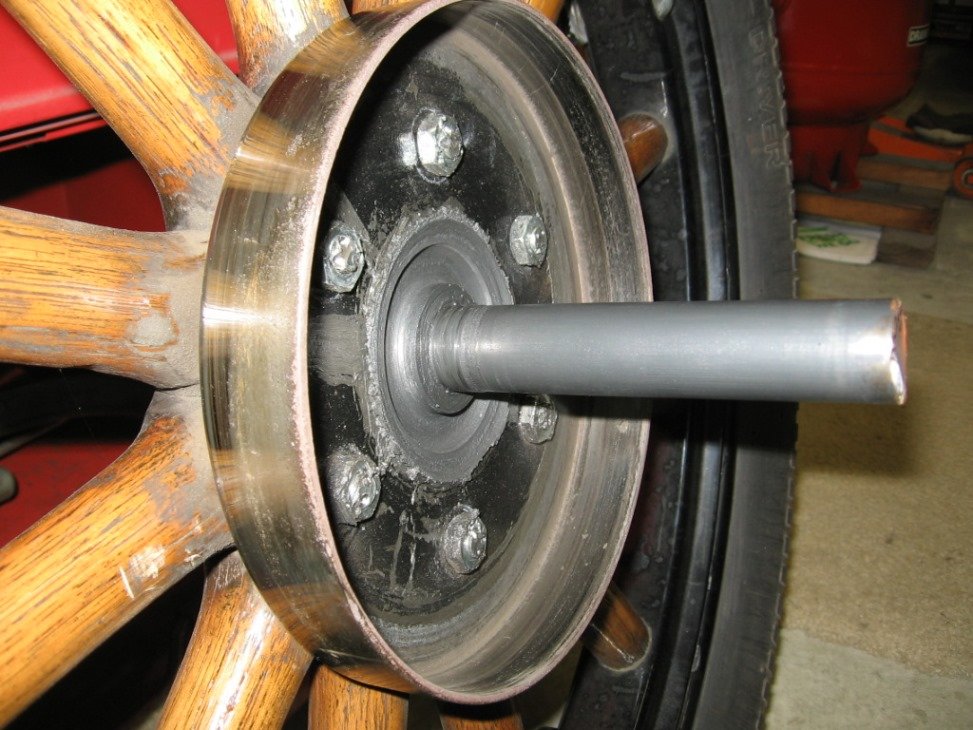

My 1924 sheared an axle shaft a few years back. I use OEM Ford Hyatt bearings. From the rusted surface, it looks like the crack had been spreading for a long time. The location of the crack lined up with the spring "fingers" that supported the Ford style leather inner oil seal.

So Mark, did you ever figure out why? bent axle housing(s)? Brand x axle? Washboard roads? Stunt driving?

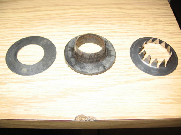

Seriously, my theory is that the hard steel spring "fingers" backing up the leather seal were rubbing on the axle shaft, and over the years a crack started in the scratches and slowly propagated in fatigue until it finally broke.

It’s very very common to see a broken axle shaft that is broken where the ‘26-‘27 Ford style seal has scratched a little groove in the axle shaft. So common that you shouldn’t re-use an axle shaft if it has even a hint of a groove there. It’s also something that was known about back in the day. I seem to recall mention of it in an old reference book or a trade magazine like Ford Owner & Dealer or something similar.

that all makes sense. thanks for that info.

While the torque loading may be different between Model T and A, Mark's axle clearly failed in bending mode due to metal fatigue. fwiw, jb

Adam, it's funny you bring this up. I thought about going this route on my rear axle rebuild, but decided against it after I read you need to cut off the ends of the axle housing tubes to ensure the bearings go in far enough. The downside is once done you can never go back to the hyatt roller bearing as the sleeve/bearing would stick out of the tube.Adam wrote: ↑Thu Mar 11, 2021 10:55 amIn viewing the above image, does anyone think the “new, better bearing” is a bit shadetree? The instruction even says it isn’t an ideal fit...
I agree that less of the axle shaft is carrying the load. More psi on a lessor area. Just my opinion.
