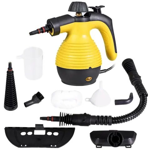

Couple of detailing shops here steam clean engines.
I used one of these to clean my engine, was on a stand and had a pan underneath to capture the residue. Worked great, no mess. There are several others like it but this is what I'd get again. This link show cleaning a headliner with a steam cleaner https://www.google.com/search?client=fi ... az2qKYCw25

I purchased a small steam cleaning unit from Harbor, but haven't tried it out yet..Maybe?

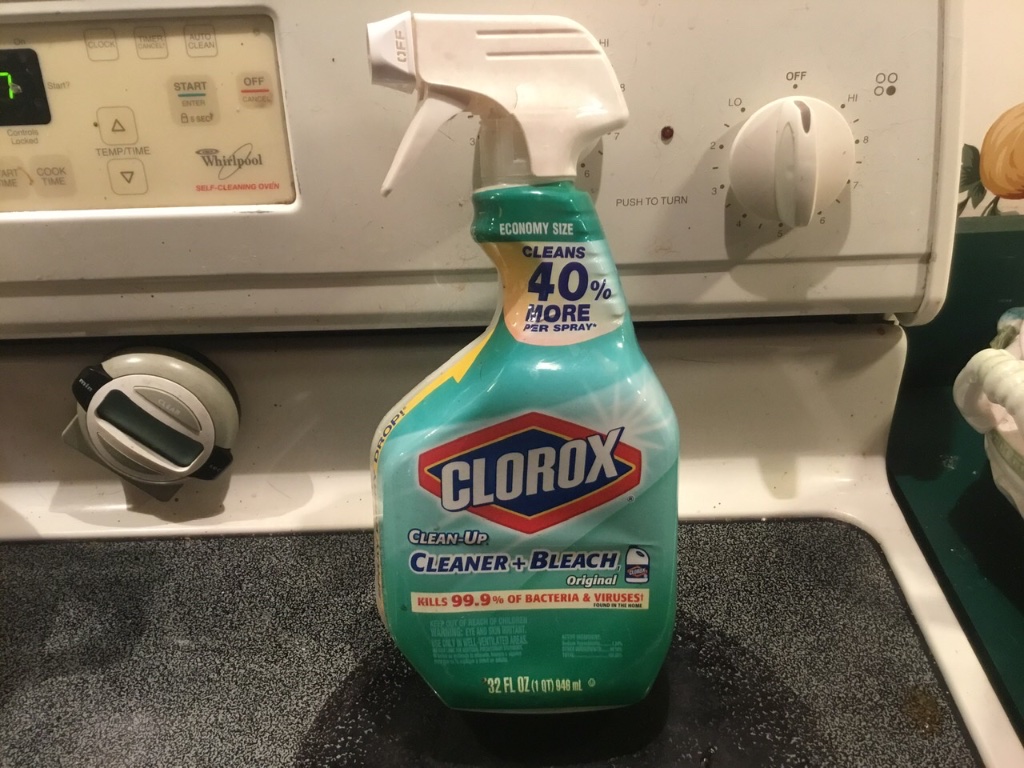

Spraying on a diluted mixture of Clorox and water and letting sit will kill the mold and mildew. Clorox also has a bleach based spray on cleaner that will work well (see photo). After the mold and mildew lightens up from dark green to yellow, it is dead. It might even disappear altogether. Once it is dead, wipe clean with a damp (wet, but not dripping) clean cotton cloth. After spraying, immediately wipe up any overspray that may have settled on the upholstery or interior. Lowe’s has plastic bags of great quality, white cotton rags in the paint department, like old soft T shirts. Jim Patrick
