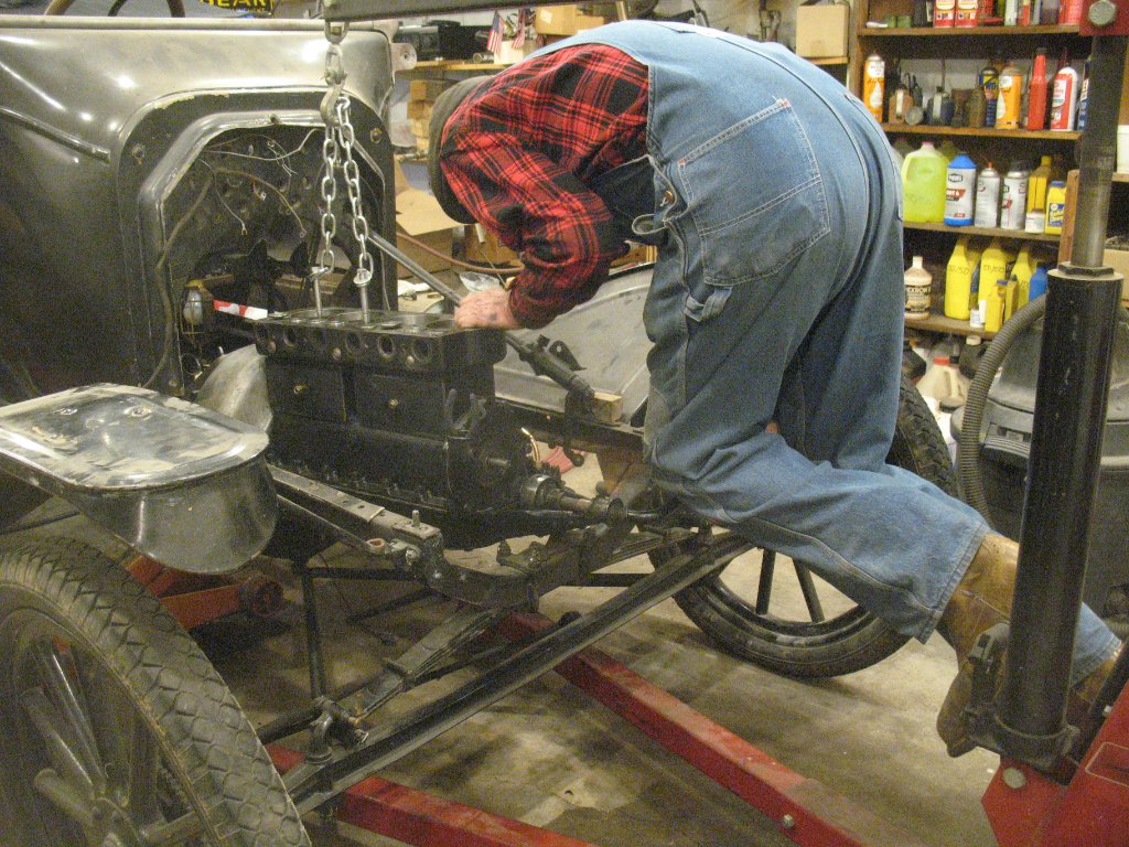

This is both mystifying and infuriating. I thought I would turn the engine to line up with the U-joint and found it absolutely stuck solid. Even putting all my weight on the hand crank won't budge it. When it was on the stand, before I nstalled the pan and the hogshead, I could grab the flywheel and turn it, but nothing will move now. I suppose I will have to put the thing back on the stand, pull the hogshead, and try to find what's stuck. But first I'll go and do some other things while I calm down. :(

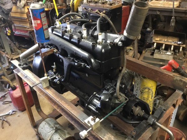

Is that pliers you have resting in the oil filler hole jamming the timing gear?

Adam wrote:
Fri Mar 12, 2021 3:29 pm
Ooh...Adam good eyes....missed that!

And, I'd remove pliers and install the oil cap!

Bands too tight? Nope. Loosened the reverse and brake as far as I could without the nuts falling off. Loosened the low band all the way. Still stuck.
Pliers jammed in timing gear? Nope. Pliers are out, cap is on.
Mismatch of hogshead and bands? Nope.They're all the same ones that were there before.
I'll try the ball cap idea, but I doubt it's binding. It went on easy.
Magnet gap is set wide. .035" to .040".
Too stuck from sitting to turn with the hand crank? Maybe. It's been sitting with new rings and valves since July. I'll dribble some 3 in 1 into the cylinders and let it sit overnight. Or should I use MMO? :)

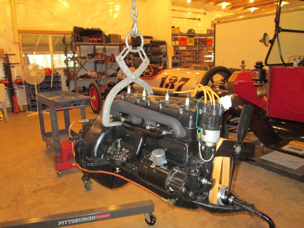

As an aside, how do others feel about hoisting the engine /trans assembly on two head bolt holes, especially with the chains attached to the end of the bolts? Is that asking a bit much of 100 year old cast iron? My three legged chain fall goes down to the pan rail at the back.

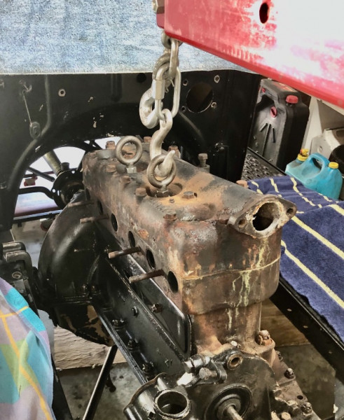

Posts: 4090
Re: Engine stuck, old man steamed
Post by DanTreace » Fri Mar 12, 2021 8:28 pm

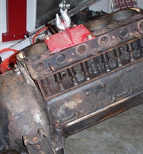

Allan wrote:
Fri Mar 12, 2021 7:21 pm
To me ....if the block threads are good condition, and clean; then using bolts there is OK.
But those tall and spindly bolt shanks could twist and bend, as the engine is tilted. Use of a block plate, solid to the block, and two or more bolts, flush and secure, spreading the load on those 7/16" bolt holes is OK to pull with little risk.
Or, for me the special plug lifts, when the cylinder head is installed is plenty safe. The pull out force of 1/2" pipe thread of steel in iron is well over 1,000 lbs.

As far as lifting a complete engine for removal or replacement - I've got a "2 plug" gizmo that's adjustable to tipping or this is the best tool !

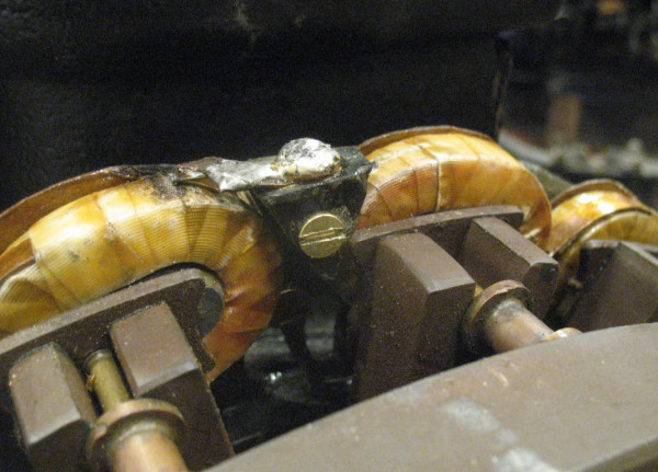

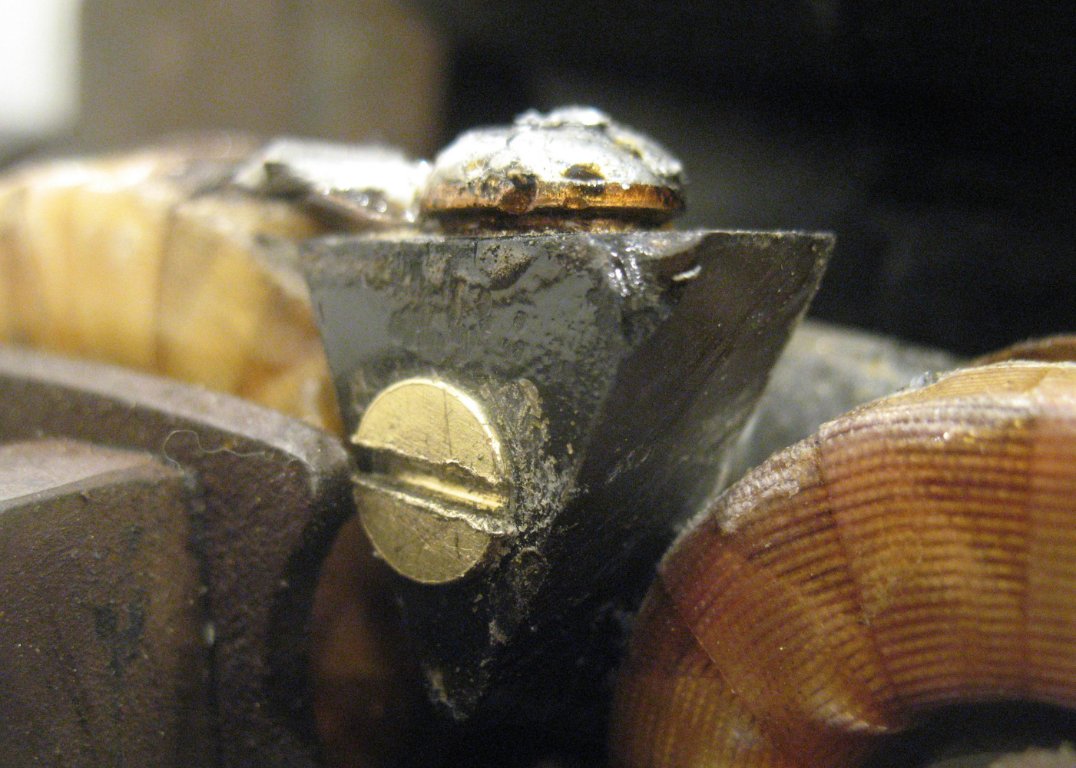

SCAT crank, no dam. But did I get the horseshoe in upside down? Nope. Took off the inspection cover and inspected. Horseshoe was AOK.
So at that point I figured it had to be something under the hogshead. When I pulled it I found that was right, but the problem wasn't anything I or anybody else would have guessed.
When I assembled the mag ring I didn't have the proper rivet, so I used a machine screw to hold the base for the solder blob. I didn't make the countersink deep enough, so the screw head was out far enough for a magnet plate to get stuck on it. When I turned the engine backwards it moved about an inch until the other magnet plate hit the screw. This will be a fairly simple fix.
But before I put that hogshead back on I'm going to take the time to make a pedal spring compressor and perhaps make pedal installation a little less annoying.

From your other post "Installing the hogshead: Is there a better way?" it looks like something more, happened since installation.
Steve's Magneto.jpg (64.8 KiB) Viewed 12904 times
Vern (Vieux Carre)
It's Bill
Posts: 279
Joined: Mon Jan 07, 2019 6:41 pm
First Name: Bill
Last Name: Hoffer
Location: Mars, PA
Post by It's Bill » Sun Mar 14, 2021 8:19 am
Yes, it looks like you need to do more checking. After the steam clears out. Keep in mind this is all fun! Cheers, Bill
Posts: 4090
Post by DanTreace » Sun Mar 14, 2021 10:12 am
Vernon
Good look back to earlier photos.
I too wondered how that mag contact on the ring got snagged, and pushed down.
Since it was nice before hogshead on....believe now the hogshead dragged on install, too close to the ring, since it’s a ‘15, would be alum hogshead, easy to wrestle around by trying to set pedal shafts too and force to wrong spot?

Hmmm, looks like the screwdriver slot on the newly rebuilt mag ring is vertical.... on the "stuck" one it's horizonal.
Post by Norman Kling » Sun Mar 14, 2021 10:43 am

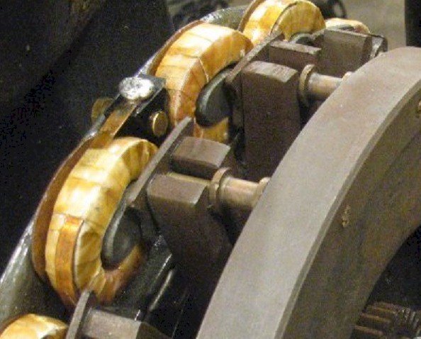

I can't quite tell from the picture, but is that triangular block pulled out from the mag ring? If it is flush against it, then it is too thick and sticks out too far toward the magnets. Notice the picture posted by Varmint That block should not protrude farther than the coil rings and yours looks like it does.
Posts: 7411
Post by Steve Jelf » Sun Mar 14, 2021 12:29 pm
Gee, we do have some observant folks here.
This view may show better what's going on. The triangle as originally installed had the solder blob too far forward, so it was not centered in the mag post hole. When I moved it toward the rear to center it in the hole, the screw wasn't countersunk in the triangle enough. Here you can see the magnet plate hitting the head of the screw. I will be making a better triangle that will position the blob correctly without a screw head sticking out.
With the triangle and blob removed, the engine now turns freely all the way around.
