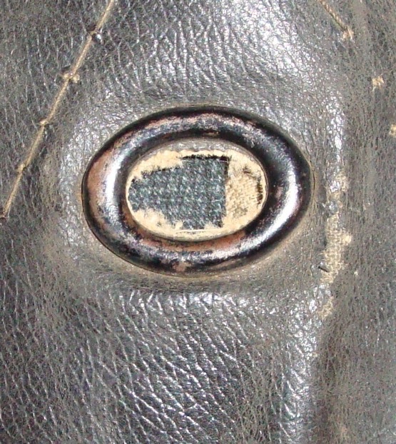

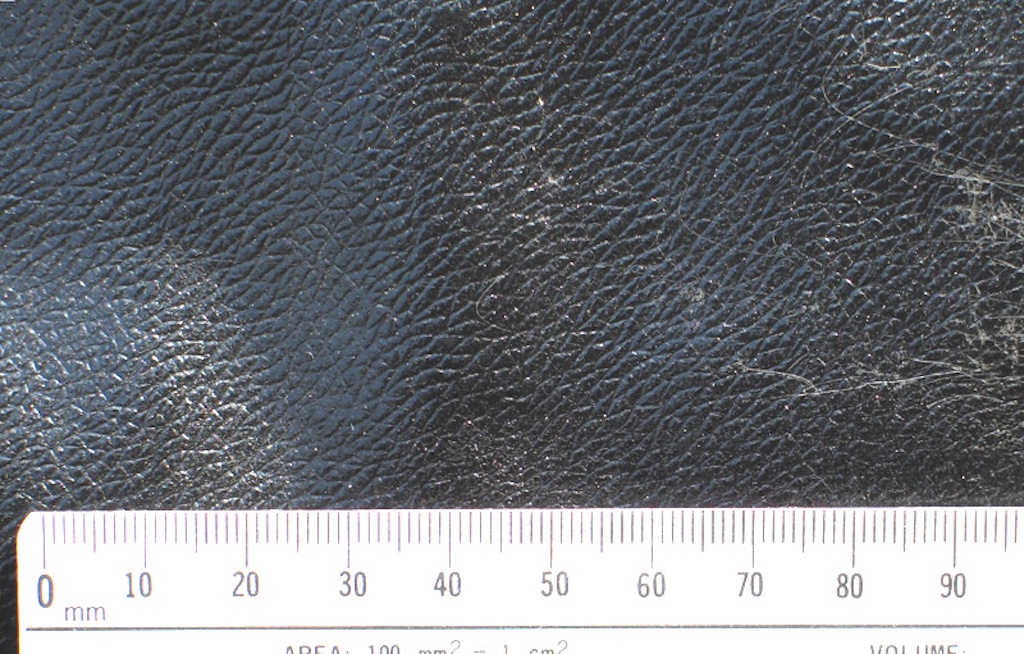

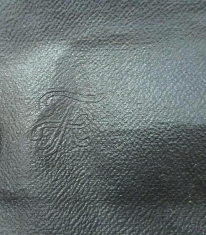

Original material was artificial leather, was called Ford 'Leathercloth', made by Ford. Woven cotton backing with a pressed on design grain covering of paint related chemicals, to mimic leather.
As the best looking grain, that is the Turf Grain.
This is second best, Colonial grain
This is best, Turf Grain, very very close to the Leathercloth design. What Classtique uses , it is a modern vinyl. Compare to original Ford Leathercloths:
