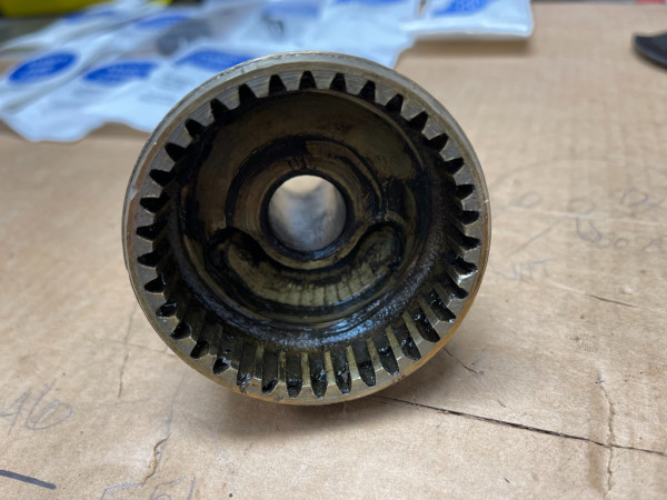

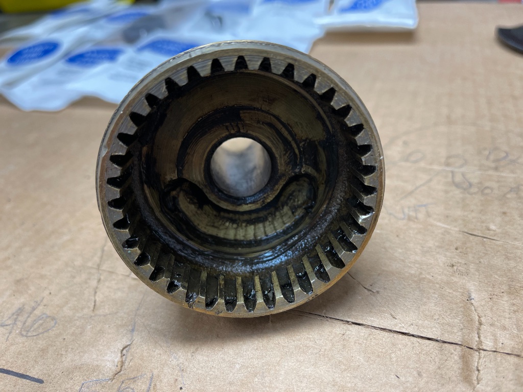

Rebuilding my column on the beater pickup truck build and found this.

Long pin drop into the slot to keep from over steering. That is the way they were made. If you look at the 3 pins on the shaft, one should be longer on the back side to drop into the slot.

Post by dmdeaton » Sun Mar 14, 2021 12:25 pm
Ok
That makes me feel better

It looks wore rather than machined. I will clean it up and try the gears

Remember to keep that arc slot on the TOP when you put the steering gearbox back in the steering tube.
The actual bearing for the steering shaft is the flat area just adjacent to the hole the steering shaft fits through. It is somewhat truncated due to the arc slot, but I have never seen very much wear at that point. There really isn't very much end load on the steering shaft.

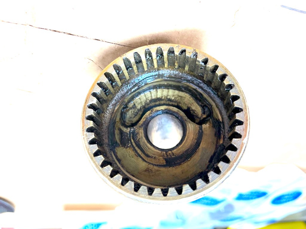

Lightened up your photo. That case for the 5:1 gears seems ok. The image is at an angle, but the teeth seem good to go. Just clean out the old grease to check.
Plus rotated the picture to show how it should be in the column, driver view. The slot is up.

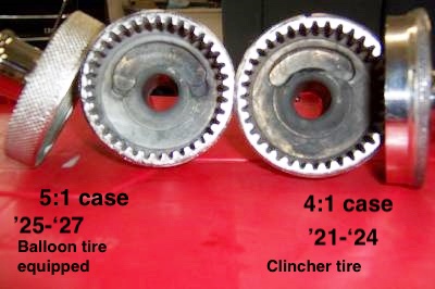

Here is comparison of the slot widths of the two types of cases.
late and early case with groove .jpg (43.83 KiB) Viewed 1583 times
