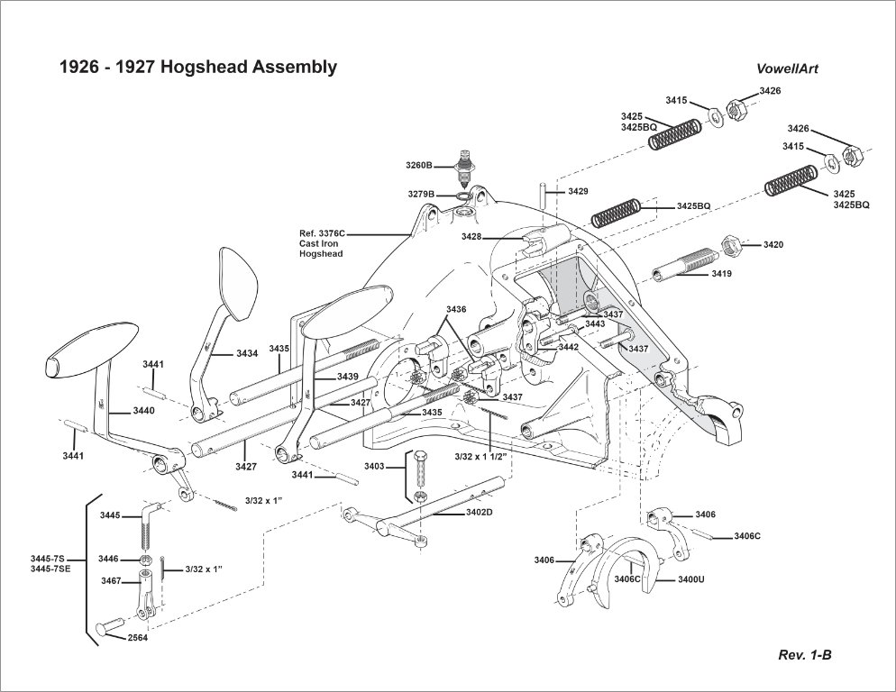

Post by VowellArt » Sun Mar 14, 2021 8:10 pm
This one I'm not so sure of, so please look it over and let me know where any changes should be if any. ;)

Post by VowellArt » Mon Mar 15, 2021 4:29 am
Had to make a small correction on the Clutch Fork, in that the shaft and the linkage lever is forged as one piece.

Post by VowellArt » Mon Mar 15, 2021 9:39 pm
Small correction; forgot the part number for the Magneto Post 3279B.

Post by varmint » Tue Mar 16, 2021 12:08 am
thanks Martynn,
I put it in the same folder as the 26-7 transmission assembly.
