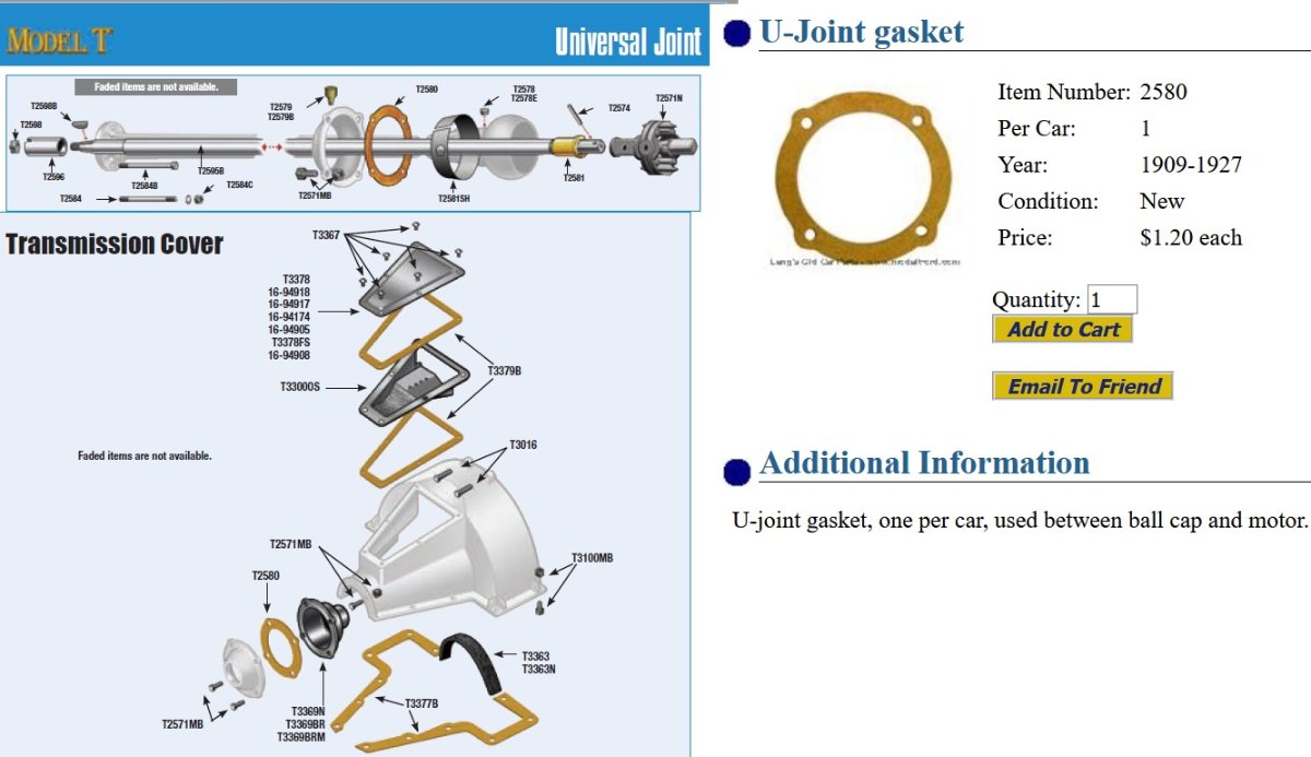

Rebuilding my '26 coupe and found the usual gasket between the 4th main and the hogshead/engine pan end. It also had a gasket between the ballcap flange (p/n 2576) and the 4th main mating surface. I believe the only gasket should be the one to seal the 4th main to the transmission end, is this correct?
Mac's wonderful illustrations show a gasket between the flange and 4th main and my coupe had one in that location, although it is obvious that the driveshaft-differential assembly had been molested between the time it left the fatory and when it was parked in 1943. Thanks, jb

The Ford parts book shows only one gasket per car, and it's listed with U-joint parts (#2580). But I use it between the front ball cap and the transmission along with a smear of Ultra-Black. That's where you want to keep oil from leaking out of the transmission. For the rear U-joint cap I use the Ultra-Black only.

Lots of contradictions in supplier pictures but owner info experience prevails and makes sense
"Is there a gasket on both sides of the 4th main? There should only be a gasket on the front, no gasket on the rear. If you have a gasket on the rear, it increases the gap between the rear cap and the ball, which allows more leakage." from http://www.mtfca.com/discus/messages/59 ... 1468619814
Supplier images /info contradictions.

Thanks, all: The Lang's illustration looks like the incorrect one in my old Mac's catalog.
