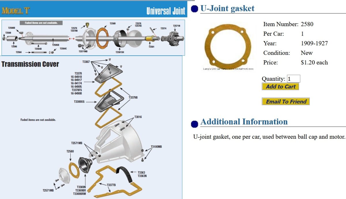

Lots of contradictions in supplier pictures but owner info experience prevails and makes sense
"Is there a gasket on both sides of the 4th main? There should only be a gasket on the front, no gasket on the rear. If you have a gasket on the rear, it increases the gap between the rear cap and the ball, which allows more leakage." from http://www.mtfca.com/discus/messages/59 ... 1468619814
Supplier images /info contradictions.

Thanks, all: The Lang's illustration looks like the incorrect one in my old Mac's catalog.
