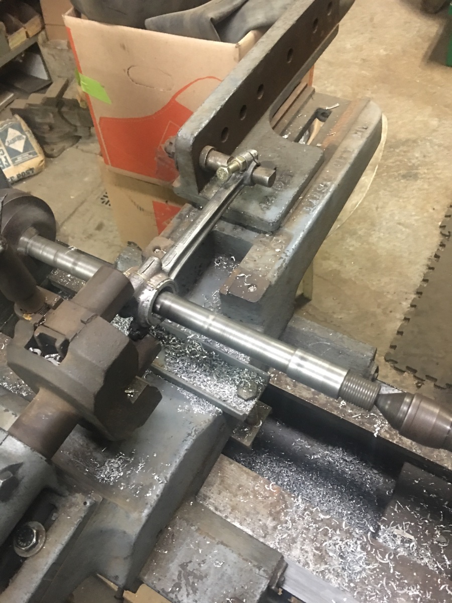

Nice!
What did you use before?

Long ago we used to do them on a big conventional lathe and I have I have also done them on a milling machine.

Eric,can we see a wider shot of the lathe. Does the table with the rod assembly travel, or does the toolbar do the travelling?

Will post more pics and info.
