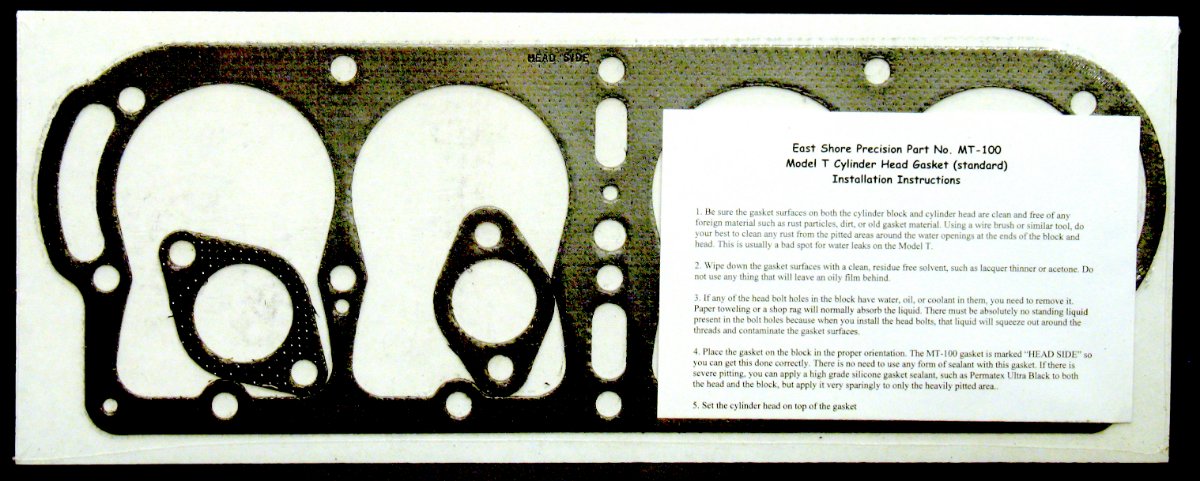

Steve Jelf wrote: ↑Wed Mar 17, 2021 11:10 amFor a head gasket contact Adam Doleshal.
I do have a few of the graphite head gaskets available. If you need one, just email me thru the forum. (Click on the contact “cloud” with the three dots inside it and then click on the envelope that appears)

AdamAdam wrote: ↑Wed Mar 17, 2021 1:01 pmSteve Jelf wrote: ↑Wed Mar 17, 2021 11:10 amFor a head gasket contact Adam Doleshal.
I set you a email
