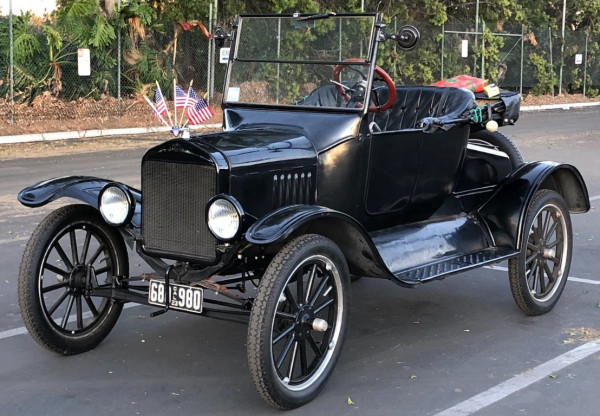

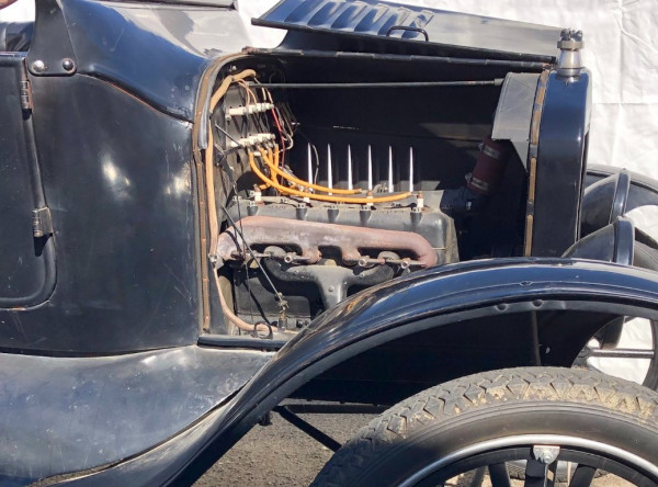

After my '23 developed a leaky head gasket that made a big mess in the cooling system I painted the freshly cleaned radiator with a Krylon Industrial semi-gloss black. It was just one light coat and it has been on for ten years or so with no overheating issues even in heavy summer SoCal traffic. This paint is very good, I painted the whole engine with it and it does not burn off or chip.
These pics were taken years after the paint was applied. The finish still cleans up well.
