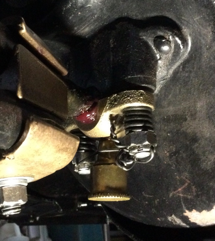

I just replaced the wishbone ball cap but I put in a grease cup into the cap. What do you think. I know, I have to take it apart again because the cap does not fit tight against the pan, but the grease cup I think will make it easy to get grease into the wishbone ball without having to take everything apart every time. Frank

Frank,Sarikatime wrote: ↑Sun Mar 21, 2021 2:48 pmI just replaced the wishbone ball cap but I put in a grease cup into the cap. What do you think. I know, I have to take it apart again because the cap does not fit tight against the pan, but the grease cup I think will make it easy to get grease into the wishbone ball without having to take everything apart every time. Frank
The cap does not have to fit tight against the pan. It's better that it gaps. This way, the springs can gradually take up for wear and the joint always remains snug. If it did fit tight, there'd be no reason for the springs. Just be sure the springs are nearly collapsed so that they can't be further compressed and allow the cap to drop enough to let the ball out. Looks like you've got it all adjusted really well.
