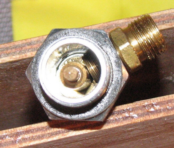

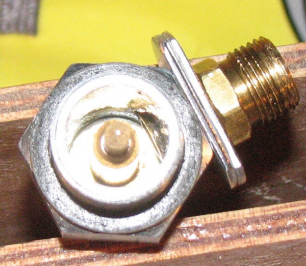

I tried the compass, and cant seem to get the needle to point directly parallel with the engine. I will remove the inspection cover and try to align the contact screw with the contacter assembly pin manually. I have "crimp on" ring connectors for the cable so that I can attache it to the contact pin. My plan is to "flash" the circuit to either the hogs head or the frame.
Question: Should the brass screw make direct contact with the pin?

If you can get the compass to be generally north. (or south depending on which side you are lining up on)
Look at the magnet screw ends on the flywheel. rotate the flywheel enough to center those screws equally to both sides of center mag post. Double check for your north reading. You are ready for the ZAP.
I am not real keen on running voltage thru the mag post connection. I prefer to remove it & make the connection directly to the field coil solder blob.
I use an old valve with a piece of tubing to insulate to make the contact. hold it down tight. (dont want any accidental arcing in this area)
This is manditory when using an arc welder for the recharge.

sorry, i dont understand your question about a screw & pin.

your post 7 posts above this one. I am guessing I need to split the screws evenly with the contact post in the center. Also; i have the old contact assembly that I can use to "flash" the magnets, then replace it with the new one when I am through. From what I have read; 3 or 4 arcs should suffice per magnet. Just to clarify: + to the contact pin when N is aligned; - to contact pin when S is aligned; Correct?
