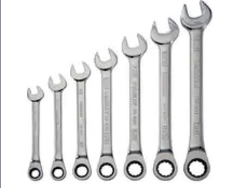

Tools and Spare Parts that You Need to Carry When Touring
Bailing wire, duct tape, and zip-ties
Oil, oiling can, grease, gas can, radiator water
Open-end wrenches: 3/8", 5/16" 1/2", 9/16", 5/8", 3/4", 15/16" w/ breaker bar for axle nuts

I would sub the 15/16 for a socket and breaker bar esp if the nuts have not been fully seated yet.

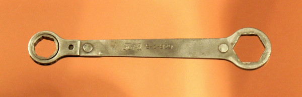

Specialized wrench for adjusting transmission bands, the medium crescent wrench will do that.
So will the little #1917 Ford wrench, but the Ford 5-Z-829 is so much handier than either of them I keep one in my tool box./

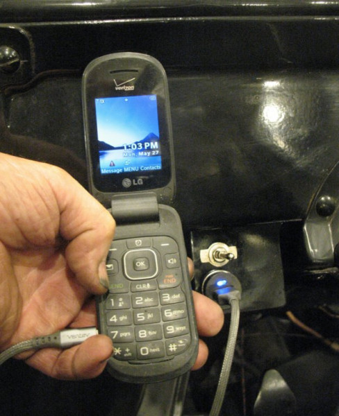

You can charge it off the car battery....add to that a 10 dollar phone charging battery.

For wrenches, I carry the ones with a ratchet on one end...they work great adjusting bands and in other uses. I also carry and Exhaust pack nut wrench, Hub wrench. Extended sockets, ratchet and breaker bar. A magnetic pickup wand on a flexible shaft. Self-fusing silicone "rescue tape" to repair radiator hoses, fuel lines, etc. Hose clamps. A roll of dental floss.
