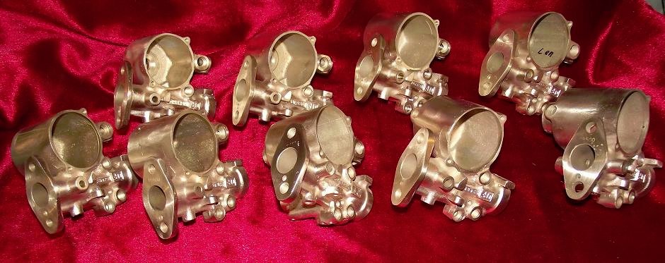

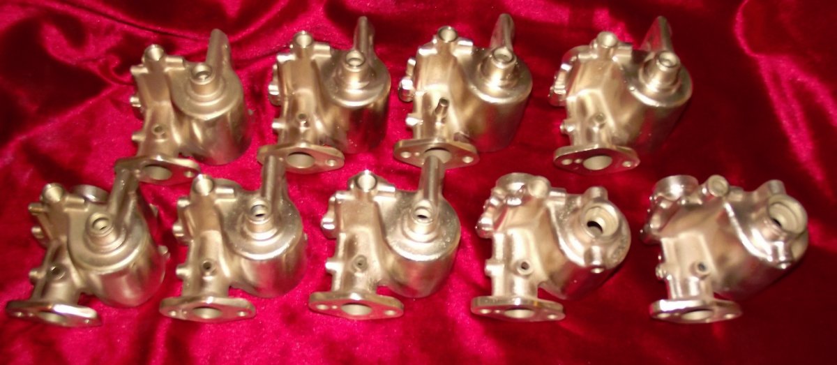

So I spent the day finishing two OF's and putting them in the mail. Should have taken a photo when I had 11 of them on the bench doing various machining processes to the mating surfaces on them. Had the other two in boxes before I thought to line them up and take pictures. So here are 9 Stromberg OF's that will be getting parts in and on them in the next few days. I've never had this many all at once before and probably never will again.
This is almost $6000 worth of old carburetors laid out on a red velvet background. With the other two it would have been about $7000 worth.

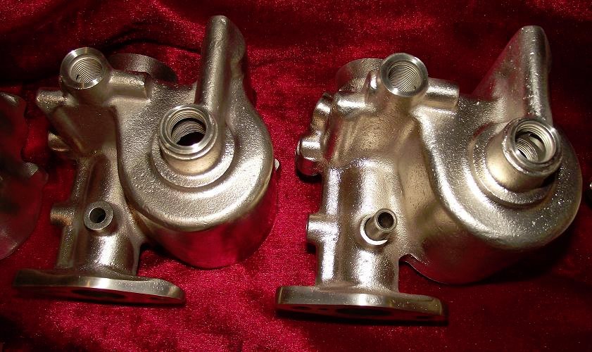

Note the machined surfaces. Every mating surface is machined flat and without chips or cracks to leak when assembled. Most of them get new plugs since the old ones are usually rounded off and ugleeeeeee. They will all get new throttle shafts, bushings and most will get new steel parts as most of the old ones are rusted and damaged so much it is easier to make new ones. They all will get my needle and seat conversion to a viton tipped needle and a replaceable seat.
These OF's, by the way, are all sold or repairs that are going back to the customer. I have one more run of repairs on OF's, should have taken a pic of the ones in the queue.
Better go to bed, I'm trying to get this run done by next week and get started on some S4BF's and half a dozen U & J's. Morning will come early.

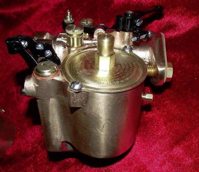

One last picture. This is the one that came in that was all full of black goop that has supposedly been rebuilt and test run. Hated to charge the guy to fix it but I can't warranty somebody else's work.

How cool seeing them all cleaned and perfect...lined up like that.

Yup, sure are purty Stan

I know that you feel like you are getting on in age but man you are undisputably one heck of a carburetor restorer. You take those things and restore them to works of art. I wish you many many more years of good health and stamina to help all of us who need your skills. Mike Lebsack

Absolutely beautiful work Stan. Thanks for posting the photos.

Most definitely the square root of AWESOME Stan!!!!!
