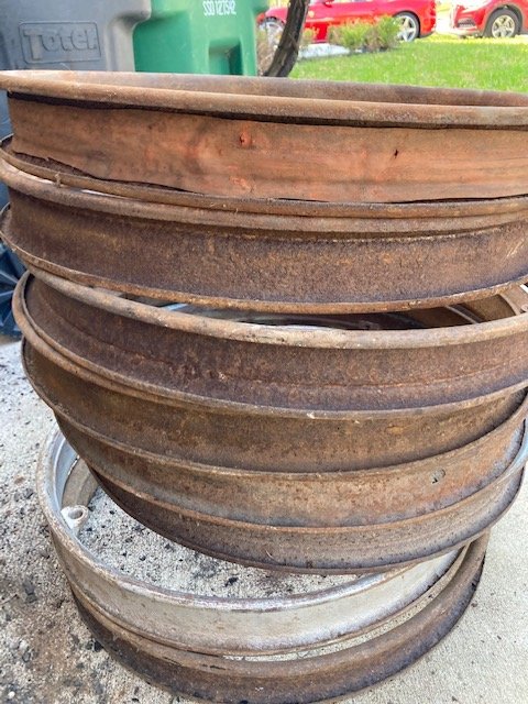

So I was tearing into my 30 x 3.5 rims acquired at Chicasha with hard as rock frayed tires on them. I had to reciproprocal saw and tire iron them off. However, inside the red inner-tubes appeared to be supple and possibly usable. On one rim it looks as though a home made flap had been fashioned out of a red tube. See the top rim in the stack, it has a red flap. Were the red tubes original to a wheel? Is there a way to tell how old the tire is from the hard tire carcass? The red tubes seem to be durable as I have some that are still good from other wheel rebuilds. I wonder what they are made of different than modern tubes?

Yessir. They are definitely a different material, being made of real gum rubber, the kind Henry was hoping to harvest from the "Fordlandia" plantation in Brazil. I believe red rubber tubes began to disappear before WW II, but real rubber (as opposed to butyl rubber and other synthetic "rubbers") was still a component in inner tubes into the 50s. Great elasticity, they made killer slingshots and other wonders that can't be had with the "dead" modern equivalents.
Others will know more.

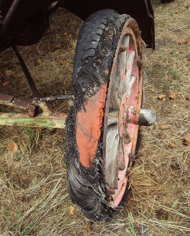

This one showed up over the Winter. They seem to survive well inside the tire. They deteriorate fast when exposed to reality.
They are exceedingly charming though.

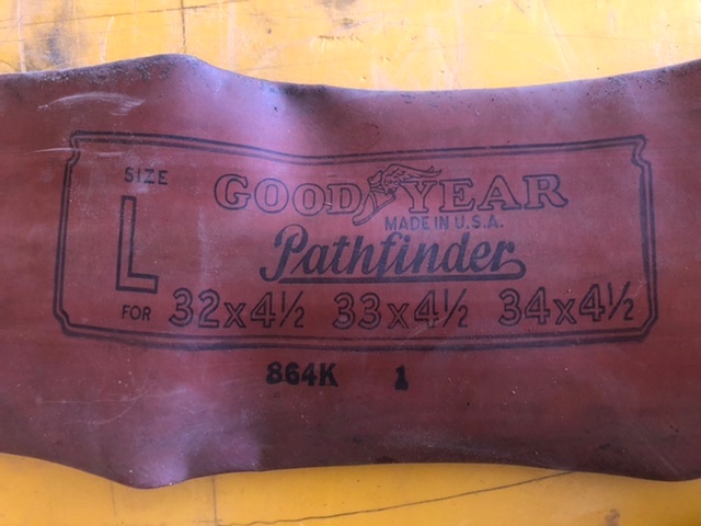

Yup. Tucked away inside a tire, they seem to survive. Here's one I had the pleasure of discovering a while back.
