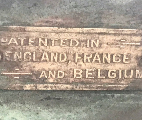

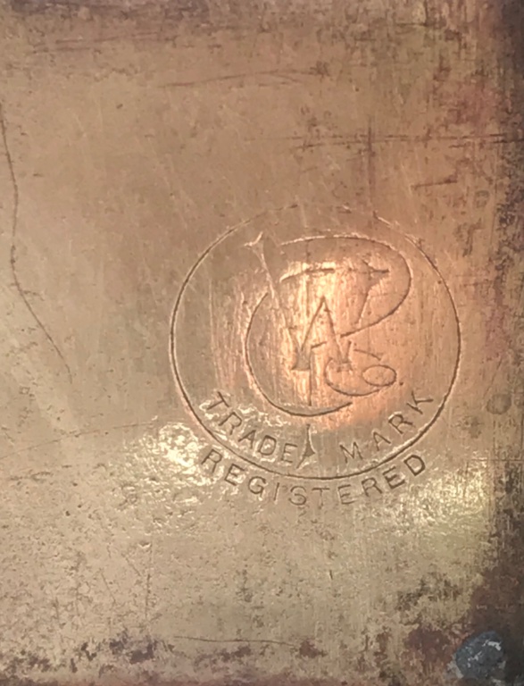

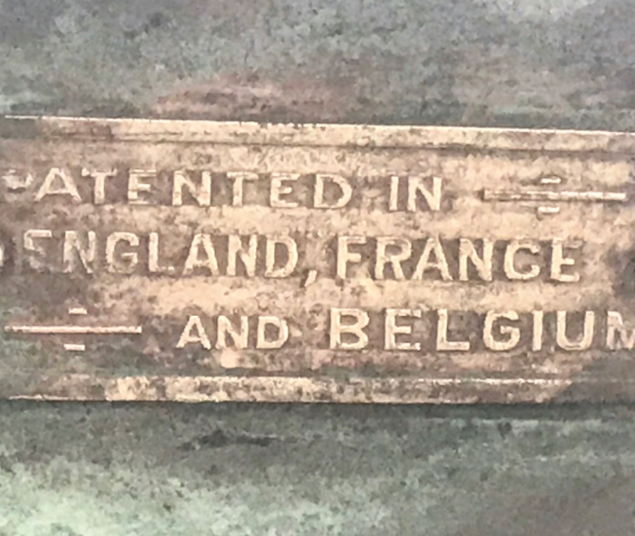

These manufacturer watermarks / tags
appear on the brass radiator of
Alexander ( the 1904 Ford Model B ).
No one has been able to identify the
brass radiator manucturer.
The radiator had to have been built before
October of 1904.
$20 bill to whoever can conclusively
determine the radiator manufacturer
with documentation.
Thanks 👋
FJ

Some combination of C W P Company. There should be a record since it is 'Registered Trademark' but after that I am at a loss.

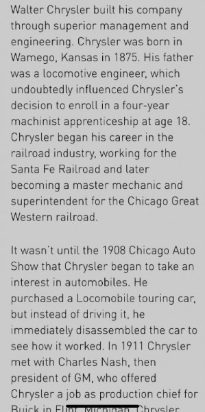

Walter P Chrysler company.

Good Guess 😉
But the dates don’t line up 🤔
He was 29 in 1904.
FJ

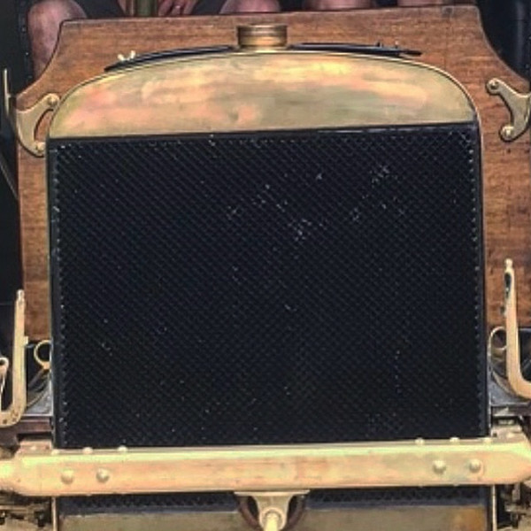

This is the radiator.
FJ

Whitlock Coil Pipe of Hartford CT. I can provide photos of another radiator with full Whitlock tags.

Robert is correct.

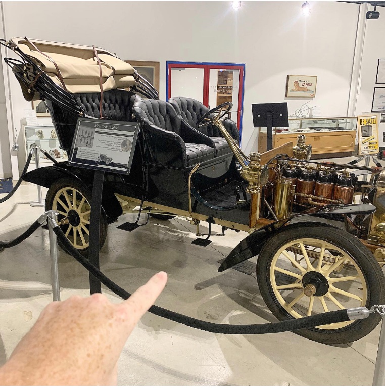

What car is that on? Do you have a photo of the whole car?
TH

Post by FreighTer Jim » Mon Mar 22, 2021 2:22 pm
Terry 👋
“ Alexander “ - the 1904 Ford Model B
is currently on display in Auburn, Indiana
at The Early Ford V-8 Foundation Museum.
FJ
