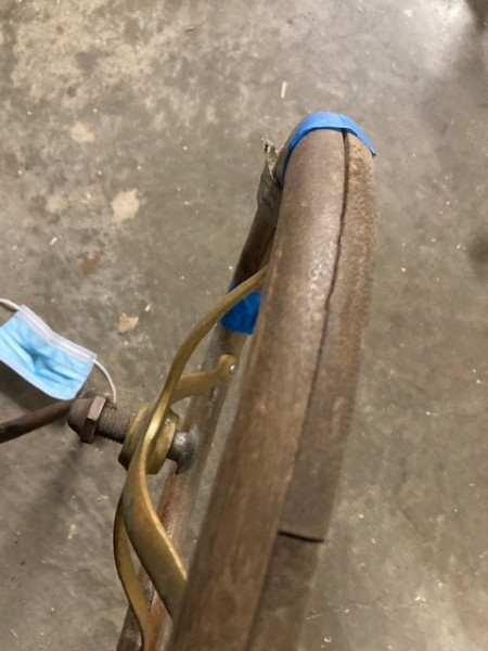

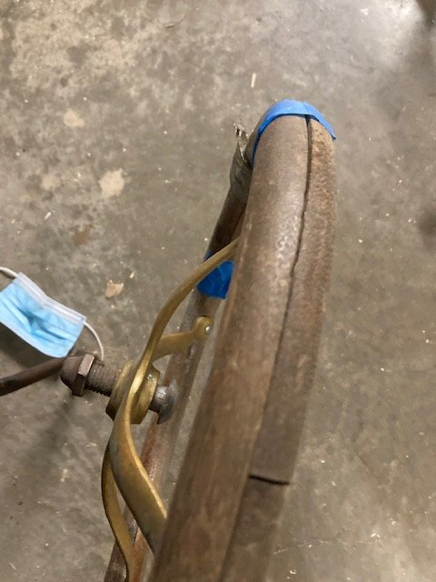

I picked up this brass spider steering wheel at Chickasha. It is held together with tape right now. What glue should I use to relaminate this? Regular carpenter wood glue, gorilla, ???

I would use two pack epoxy, with some filler to thicken it up, just because that's what I have on hand. It works a treat, is strong and weatherproof, and fills any irregularities at the same time.

With my dial-up connection, I can't see your steering wheel picture, but I can tell you NO GORILLA GLUE! It expands as it dries and will not give you a good glue joint. IMHO, it has very limited legitimate uses.

Take it completly apart, clean the old glue and dirt off the surfaces, scratch grooves into the surfaces that you will be applying glue to by scraping with the side of a hand saw. Time and effort to prep the wood is essential to a good bond. Use Titebond or Titebond II wood glue, clamp it together and leave clamped overnight. For best fit, clamp the wood parts together while it is attach to the spider.
Epoxy glue is good but has a limited working time, with all the alignment, adjusting, and clamping, it may set up before you are ready.

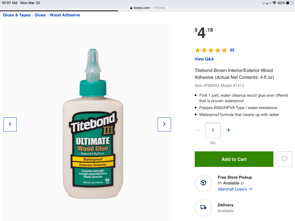

I with them but more specific its just a dollar or two more than their other exterior version

. Get the III it is truly waterproof after it dries, the stuff will not wash out of your clothes even with hot water.
