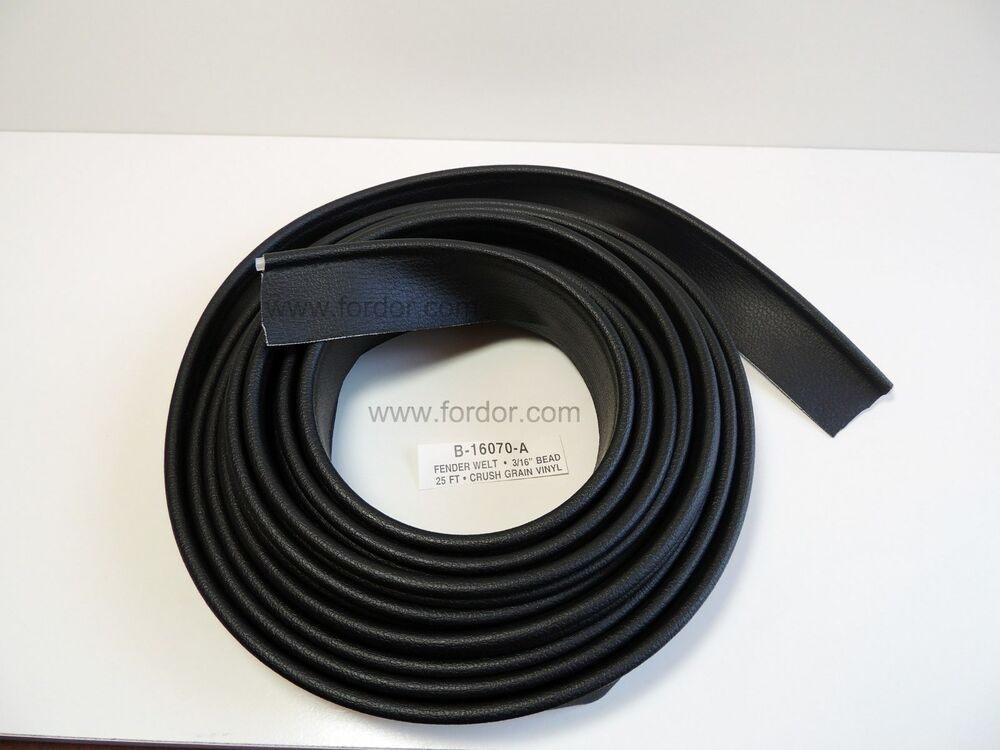

Because I thought it would be a good idea to keep down noise and vibration, I tried to install welting on my ‘26 coupe during the first restoration body assembly, but the Model A welting with 1.5” flap that slips down between the fender and the body, that I purchased from J.C. Whitney, did not go deep enough into the joint to hold. If there was welting that had a 3” flap, it might go deep enough into the joint to be held in place on the Model T. Jim Patrick

Re: Fender Rubber Strip?
The picture I posted is marked with www.Fordor.com (Howell’s Sheetmetal Co.). I went there and typed the keyword “welt” in the search box and over two dozen results popped up. Check it out. Jim Patrick
