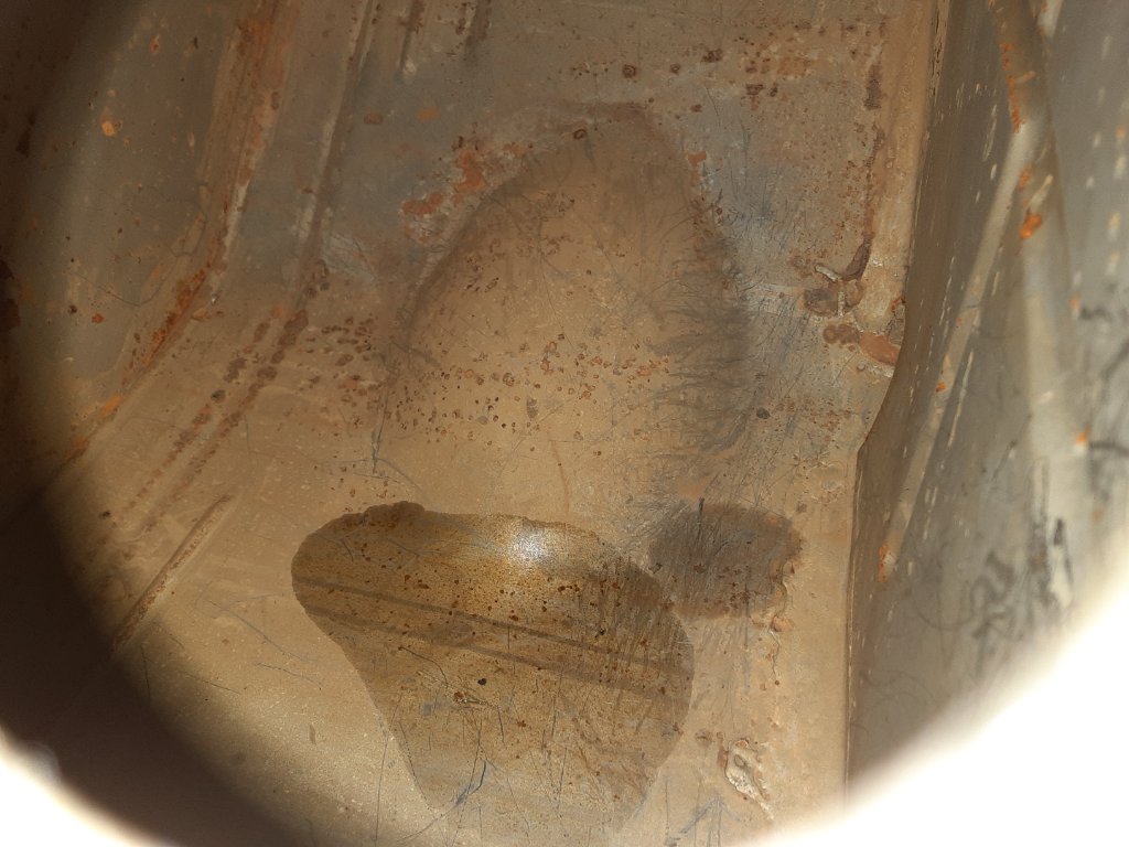

The inside looks good to me. What do you think? What should I do to it? The wet spot is penetrating oil used to get the cap off.

The tank in my ol ‘27 roadster looked exactly like that... almost good as new! However... a pressure test revealed a leak. There is a rectangular tar paper anti squeak pad between the firewall and the front panel of the tank that held water, and caused the front panel of the tank to rust thru. Now would be the time to check, and fix if necessary... before you put fuel in it!
I would rig up a rubber plug with a sensitive low pressure gage and a Schrader valve, and see if the tank will hold 1-2 psi for some period of time. If there’s a hole... it’ll bleed out right away, and you’ll know that the tank needs to come out

I forgot to mention I have the tank out of the coupe and outside looks good.

Looks clean and good, since it is out and dry I would go ahead and use a sealer as future insurance.

I would still use the POR 15 tank treatment to clean and seal the tank. We do not seem to have the fuel quality/mixes you have in the USA, so this may not be applicable for you. Others will chime in.

I think I know what sealing a tank does, but would like to know more about it. Also, I assume there are no cons to doing it.

The main advantage is that it prevents water condensation from corroding the interior of tank. Also prevents old sticky gas residue from adhering to the interior of the tank, making the flushing of the tank easier. I suppose there are cons, especially if the tank is not prepared properly, or the wrong lining is used, causing the lining to sluff off. Have not encountered those problems so, for me, there are no cons. Only pros. Jim Patrick.

That tank looks D--- good for 90+ years. Will that sealer last for 90+ years? If it ain't broke, don't fix it. Someone years from now will thank you.

Obviously, if it's your car you can do whatever you want. I just have an eye toward preservation, provided there are no leaks or problems not shown in the picture, with minimal care that tank should serve for many more years.

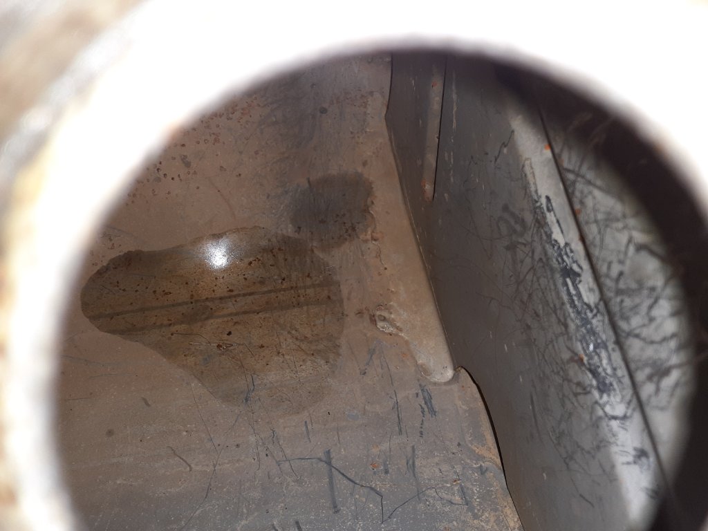

When I posted the pic of the inside of the tank, I was having trouble posting more photos. I will now post a couple more.

Beautiful !!!! I would leave it alone.

I have decided to "use it as is". What should I use to flush it out (gasoline ?)?
