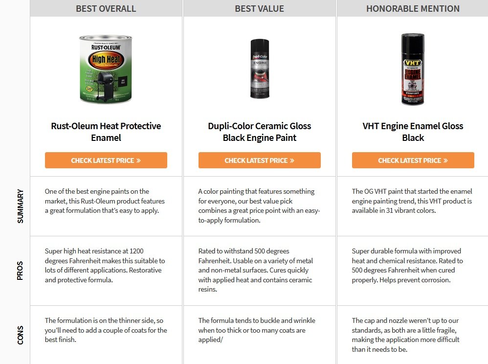

Being in the car isn’t the best place to paint the engine but if you want to do it rinse off the engine the best you can, peel off the flaking paint and use a brush to paint it. And again it will be a best you can considering the situation.
Go to a farm and ranch store and buy some rustoleum black enamel and use that.
Rustoleum enamel works well on rusty pipe, metal bins, and so on. I’ve used it on our farm on rusted metal pipe fence bracing and corner posts and it’s held up well several years outside in the elements. That’s what it’s for. Yes it’s best to sandblast, sand and clean metal but you can’t always doo that. It will last several years being hand brushed on. Especially in your situation.
- Posts: 6562
Re: Painting the chassis and engine without disassembly
While you may tape around the area you want to paint - the over-spray mist will get on everything and even into your lungs (wear a mask)
Brush paint the chassis - and you can't really spray everything like the inside of the frame rail. I prefer Rustoleum Farm & Implement paint.
Question if the engine needs paint - but again brush it on. You only need 500 degree paint for the engine - again Rustoleum engine paint. The secret is to read the directions and let it cure properly. I do not like VHT (requires heat to cure). Have used Duplicolor on my brake rotors and it has held up well
