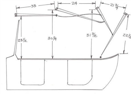

I’m about to put the top on my 24 Touring and was wondering if anyone has the measurements for where each bow goes on a one-man-top car in the fully “up” position.
I think I’ve seen it here before but my Google’s broke and I can’t find it.

Not sure of the year, but shouldn't matter if your car is late 22 - 25, this should be correct.

That’s perfect Martynn..thank you.
