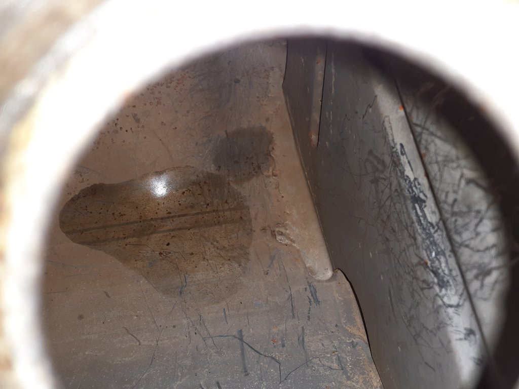

The inside looks good to me. What do you think? What should I do to it? The wet spot is penetrating oil used to get the cap off.

Post by TRDxB2 » Wed Mar 24, 2021 12:35 am
"The envy of gas tanks you have " said Yoda

The tank in my ol ‘27 roadster looked exactly like that... almost good as new! However... a pressure test revealed a leak. There is a rectangular tar paper anti squeak pad between the firewall and the front panel of the tank that held water, and caused the front panel of the tank to rust thru. Now would be the time to check, and fix if necessary... before you put fuel in it!
I would rig up a rubber plug with a sensitive low pressure gage and a Schrader valve, and see if the tank will hold 1-2 psi for some period of time. If there’s a hole... it’ll bleed out right away, and you’ll know that the tank needs to come out

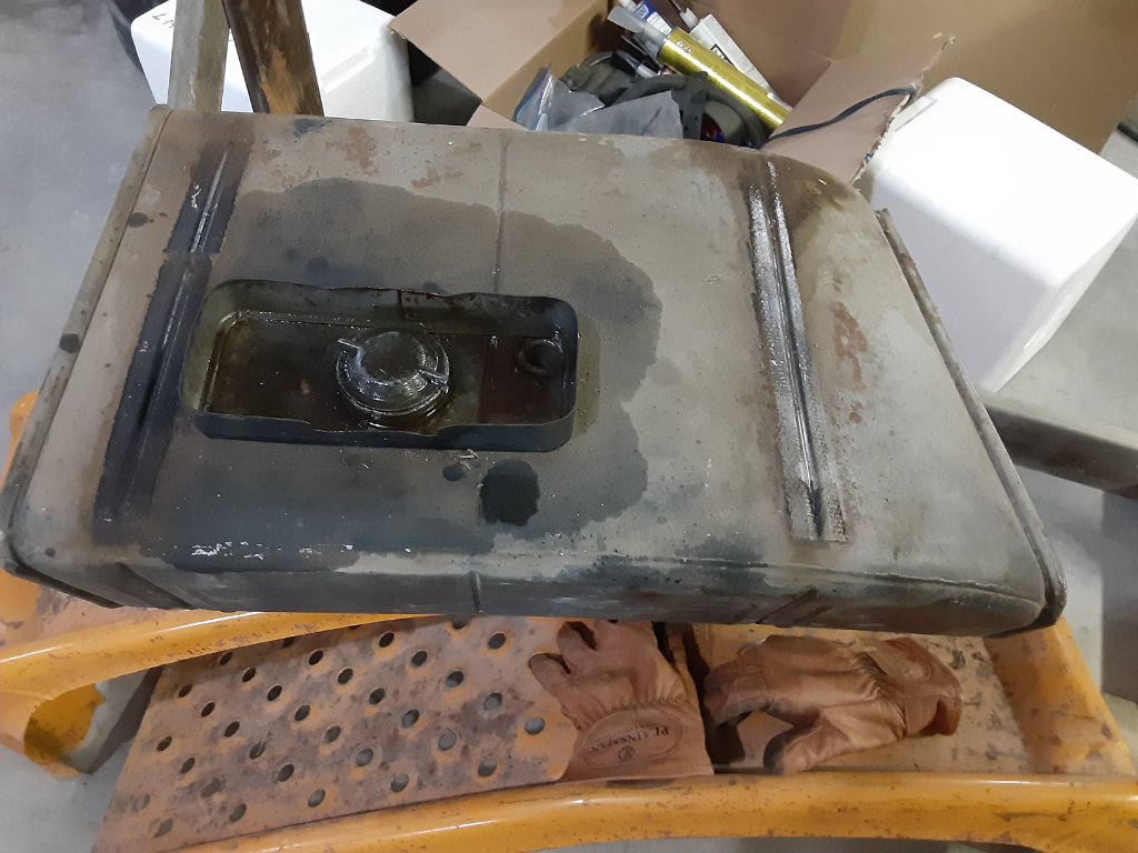

I forgot to mention I have the tank out of the coupe and outside looks good.

Looks clean and good, since it is out and dry I would go ahead and use a sealer as future insurance.

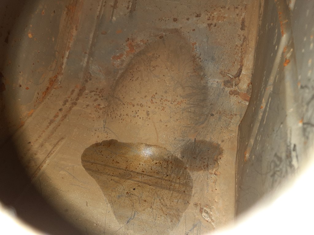

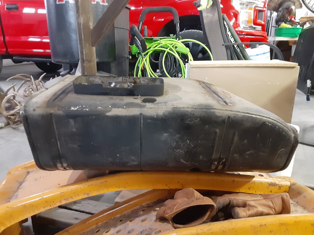

When I posted the pic of the inside of the tank, I was having trouble posting more photos. I will now post a couple more.

Post by BLB27 » Fri Mar 26, 2021 1:32 am
One more inside the tank.

Beautiful !!!! I would leave it alone.
