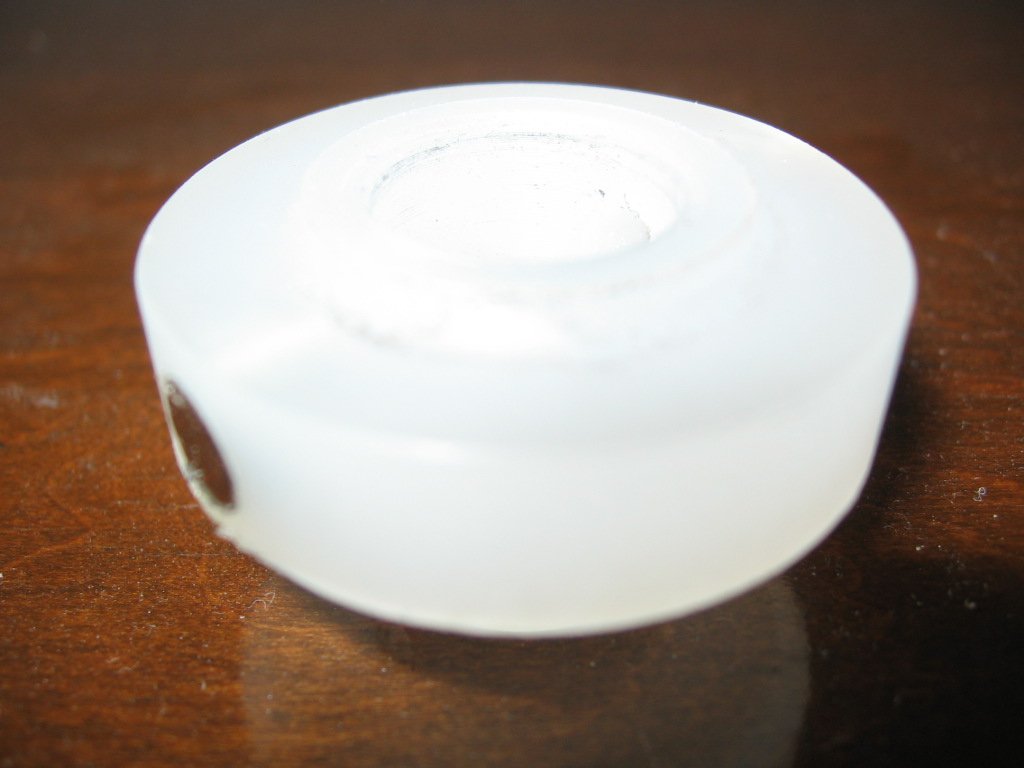

Just checked back with my friend, turns out the rotor is lost. By chance do you have a spare?
I've been in touch with Jim Golden, a wealth of information about the system. He sent me a variety of documents about the system and I have forwarded them to my friend.
Walt

Jim, if you still have those dimensions, could you publish them here? Somebody with a 3D printer could probably do a run of them.
I measure my rotor as 1 3/8 inches in diameter and 13/16 inches in height. It has two small cylindrical neodymium magnets embedded in the periphery, 180 degrees apart. One of the magnets is lined up with the slot in the nose of the rotor that the timing pin fits into. Each magnet is about 1/4 inch in diameter and 1/4 inch tall. They are pressed into the plastic so that they are flush with the surface.

I just checked, both cylindrical objects pressed in the rotor 180 degrees apart are strong magnets. :)
What is the polarity of each? I was expecting just one magnet passing a post at each sensor for the firing order 1,3,4,2. The wiring to the TRU-FIRE Box has Posts 1 & 4 (180 degrees apart on the timer) connected to the same position on the box - so I would still expect one magnet to be South and the other North. Can you check with a compass? Trying to understand.

The Truefire is indeed a "wasted spark" system, it fires a pair of plugs at a time.
Both magnets on the rotor are south poles. The pointer on my compass points at each magnet when I draw it close. Is this vital to the operation of the unit? I have no idea!

With the info you all posted here, I am able to fabricate the only missing piece : the lost white plastic rotor with 2 magnet parts piece. The rest of my True fire can work again. I had removed it when I got my T, it was working. But it rolled away !
In reverting to wood coils I found spark gaps at about .045, rod lengths were wierd, etc etc. And my T would not hardly move in low gear.
Here is the information I got from you all here I needed :
A closeup picture of the white plastic, a reference dimension, notch and pin hole relative positions to magnets and rotor shaft, number of magnets, rough sizes, that they are rare earth neodymium, flush, and type of NS polarity pointing outwards to a needle compass ! I can now Make it !
Yayyyy Thank you forum please, I have not been able to post there. I thought a T had reverse, Lo Hi, 3 speed transmission, so I could not join.
Sincerely, a Very grateful, less demoralized new T owner...

Glad you were able to post! If you make one for yourself, how about making a run of five or so? Just from the OP and other folks that have posted in this thread I think you would sell them pretty fast. :)

I could use two or three of those too, as I have two systems that did a melt down from excessive heat.
I didn't keep the measurements for that part and I forgot who was going to try to make some of them.
He had already purchased the magnets, so they are available.
I have a test set that can test a new rotor.
Moving that notch slightly could eliminate the problem of trying to stretch the spark rod.

Walt Berdan is making good progress on a home made run of replacement rotors, I expect an announcement from him soon. :)

As Mark mentioned above, I've been working on making some replacement rotors. With a couple prototypes made and tested, I will be able to make a few more if there is any interest. I'll add a post on the Classifieds - Parts section of the Forum. In the mean time, if you have an interest you could contact me at wberdan at comcast dot net.
