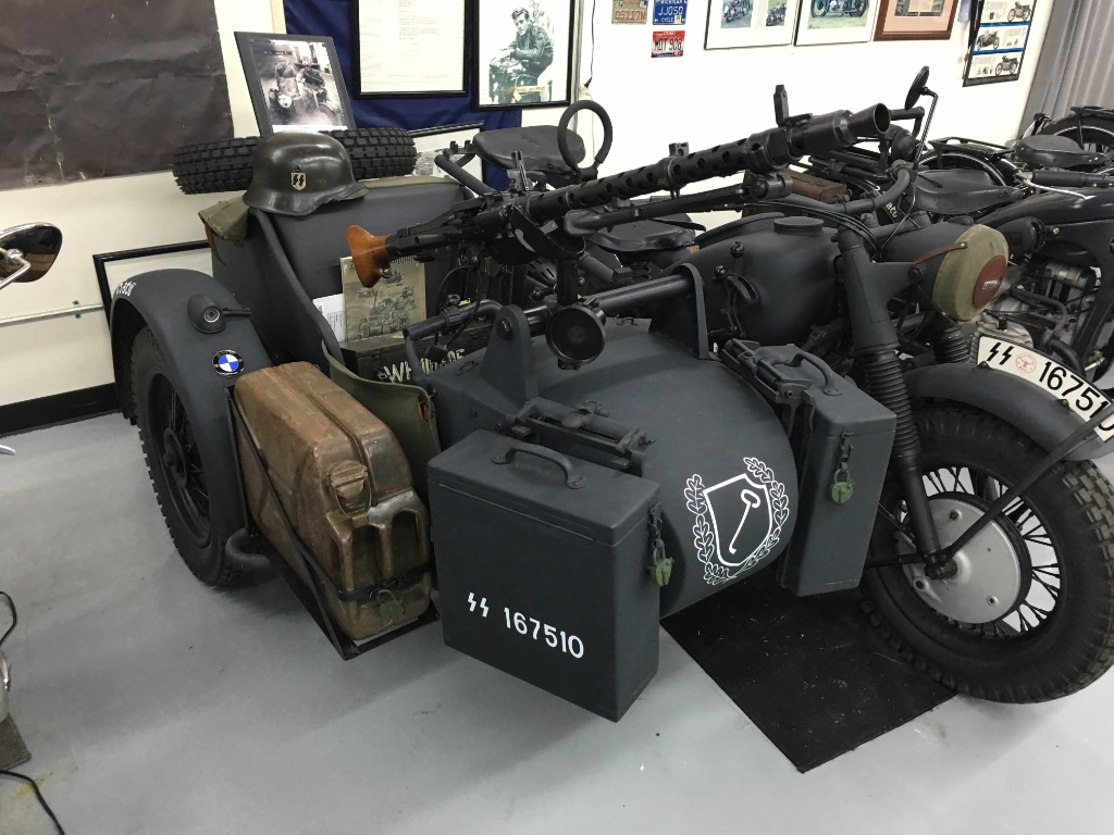

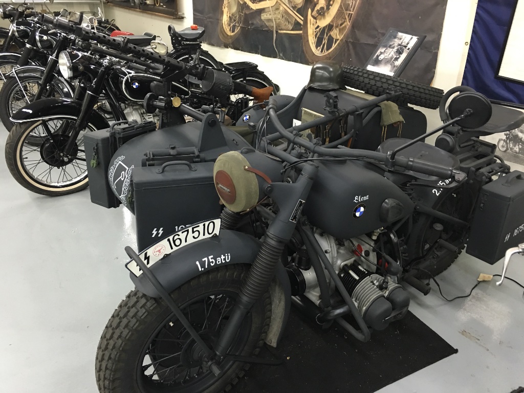

The R75 BMW was the only BMW made with a true differential that had a lock out feature. If the bike became stuck in the mud, you could lock the final drive turning the rear wheel and side car wheel into a live rear axle. When the lockout feature is used, it will no longer steer. It simply will move forward in a straight line no matter what you do with the handlebars. This is my 1942 R75. The machine has a high/low shift on the input shaft along with a a 4 speed trans with reverse. Gives you 8 speeds forward and two speeds in reverse!

Craig, did you get this bike from a guy in Phoenix?

No I bought it in Fort Worth Tx in LOTS of boxes.. it was very worn out and in terrible condition. The front end was badly bent. Lots of parts were missing. The side car tub looked like it has been attacked with a sledge hammer. During the restoration, I found a photo in the BMW archives of an R75 with two soldiers standing next to it. While it was a black and white photo, one could tell that it was definitely not a desert tan paint scheme. And, the nose art was plainly visible on the side car, and the front fender license plate was plainly visible, so I copied the scheme, and painted it RAL 7021. That is panzergrau, Tank Gray.
