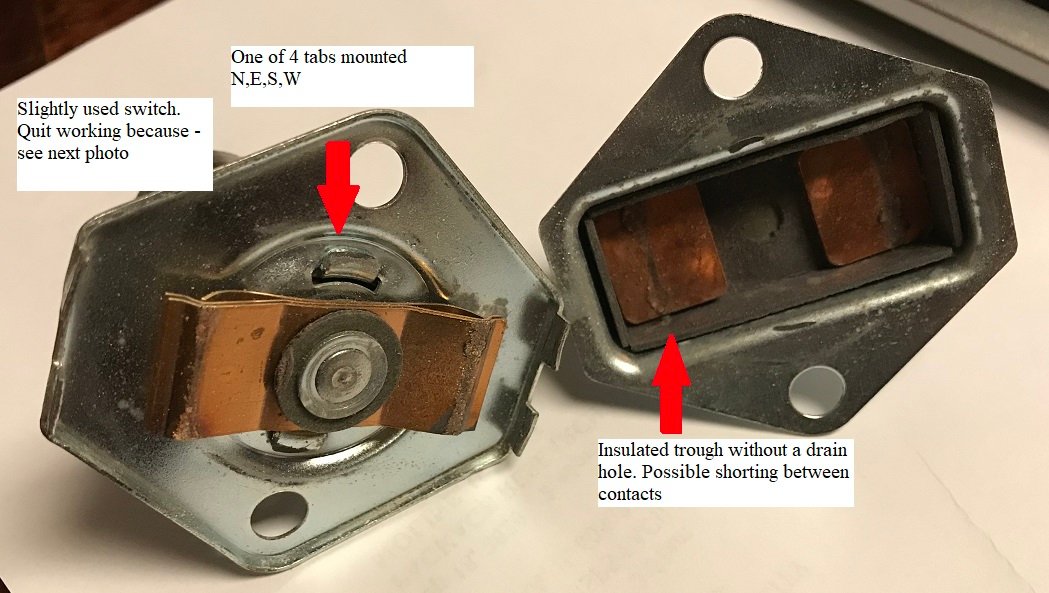

I’ve disassembled the switches to find that the contacts are so thin they weld themselves together or burn off.

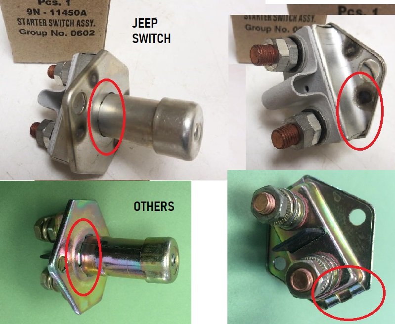

There was a previous discussion not long ago https://mtfca.com/phpBB3/viewtopic.php? ... ch#p140154 I had posted what I believe is ONE of the issues with the switch. The issue is related to how the switch is depressed. If the plunger is pushed in on an angle it may mot engage properly because how the plunger tube is connected to the base with a few bent tabs.
Another issue is the thin contacts and sitting in a steel cup with no drain hole.
Use the switch to activate a hidden solenoid and be happy

We have a Farmall H with that similar starter switch. The new switch lasted very few starts until it was fried and shorted to ground internally. The new switches are pretty much junk. I think something happened to the quality a few years back as, so far, the newer one in my T (unknown when prior owner replaced it) is so far so good.
Is this $65 switch the one referred to? Does it fit the T correctly? Additionally, will it fit the Farmall H mounting bracket? https://www.debellajeepparts.com/MB_ELE ... ATALOG.htm
If this expensive switch is one and done, I'm willing to spend $$ for quality.
Thanks,
Mike
It appears to use the same top plate but the underside is different and the plunger is connected differently. The spot welds also would make for a stronger unit versus the bent tabs. No question on the better insulation around the wire connections. Perhaps the "others" are immitations

The started switch that is bent up on the mounting bracket, due to a shorter plunger section is a much better quality switch.
The Standard Auto Parts starter switches are about $35.00 to $39.00 now and are also a much better quality switch.
