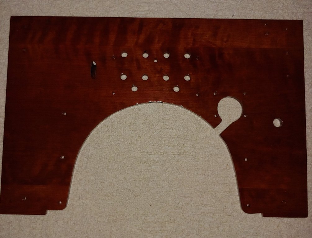

Just completed my 14 firewall, I was able to locate an unopen quart of P&L Cherry Bark Stain. Used very little.
I'll bring to Luray if anyone wants it $10.

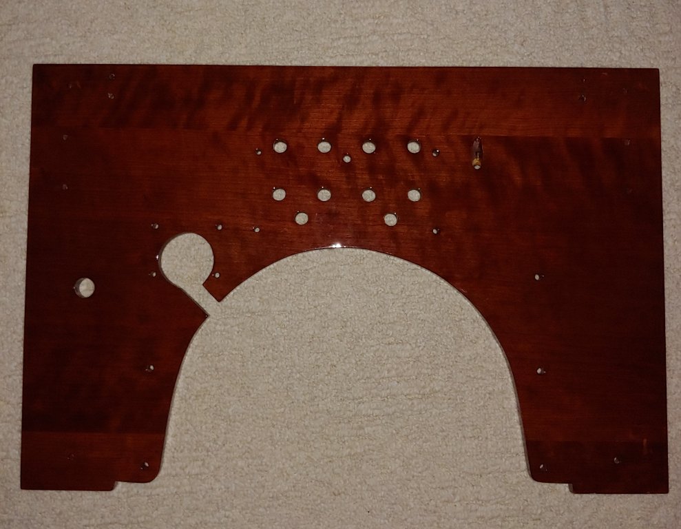

Nex question: My original firewall is slotted at the steering column hole like Brian's, but the new firewall is not, requiring me to disassemble the steering column to put it back together. Which is correct?

Steven, if you wind up not cutting the slot, the only tricky thing you need to remove from the column is the little timing lever. The pitman arm needs to come off and then the column mountin bracket will just slide off which lets you pass the column through the firewall hole. I removed the timing lever at the workbench by carefully drilling out the pin which holds it in place, and then drilling and tapping the hole to accept a small screw to replace the pin. I used a button head screw that is tightened with a small Allen wrench. It looks for all the world like a rivet after it is in place. Cheers, Bill

Steve, if it aint too late, cut the slot in it! It'll look more "natural", plus, just makes it sooo much easier with that
column, you never know when you may have to take it out again down the road. Just my thoughts. Happy Easter!

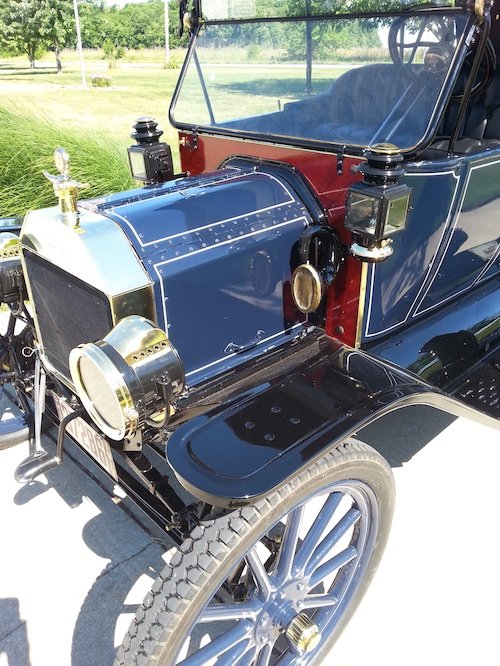

LMF website claims that their product withstands exposure to sunlight when used as guns took finishes. Who knows?
Well, all I know is, my firewall in the picture was the first summer for it, it's been 5 years now, 8,000 miles later, and the firewall still looks identical. Trust me, it's gotten LOTS of sun on it! So I would say LMF is correct, it'll hold up under the sun. Just sayin!

Did they ever have the slot from the factory, or was that a later "fix?"

Others are waiting on the report re the slot in the firewall. Original or a later 'fix'?
- Posts: 4090
Re: 1914 Firewall Finish
According to John Regan post May 28, 2014:
“The steering column slot was factory item starting during 1912 year and continuing through 1914.”

The Firewall had the slot in 13 & 14 however in 15 did not have cut out.
