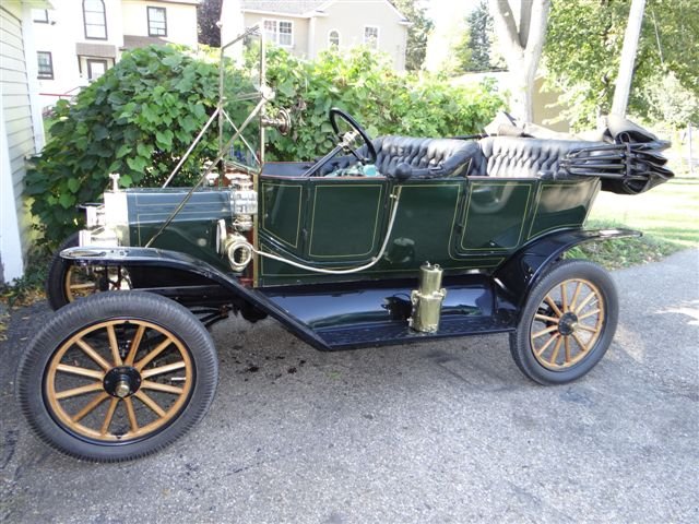

Hello,
I have had my 1930 Tudor for several years and I am planning to purchase a 1914 Touring car. I found a really nice one that has been basically restored to the way it came from the factory. This is good and bad because it has no brake lights, no Rocky Mountain brakes....etc.....
Here is my question. I am sure this would make a great show car because it looks original, but I am not interested in showing the car, I am more interested in driving the car. Besides brake lights, Rocky Mountain brakes and turn signals, what would be your highest priority to add to a stock 1914 touring car to make it safer and more usable driving on rural roads?? Ruckstell rear end? Seat belts? Water pump? Dual front wishbones?
Remember....I am not interested in showing the car...just enjoying it.
Thank you in advance for your opinions.
