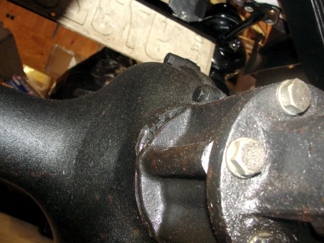

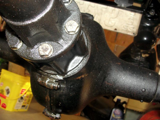

Things being what they are, I didn't get round to really looking into this until now. I climbed under the car to take a look and see if I could fathom what the hell was going on and then I noticed this.
You see that small looking flange sticking out of the side of my spool? That's the gasket spacer and it is sticking out most there so I thought that somehow the bloody thing got slipped out....but then I got to looking at the spool itself.
And it doesn't look to me like that spool is fitting properly on the axle housing. Has anybody every seen one of these slip on the housing? Because I think that this may indeed be my problem, the drive shaft has canted 10 degrees off center of the rear axle. My next question how is that possible or is it even possible? Do I have the wrong spool? My car is a early 1922 and I don't ever remember it looking like that after my last transmission overhaul.
You think I can just loosen the bolts some and "kick" it back into place or am I going to have to do something more serious, like rip the entire drive train apart and rebuild it? :?

You should assemble it as it came from the factory, i.e. studs, castellated nuts and safety wire, not bolts.
Also, you'll most likely need to align and adjust the ring and pinion gear mesh with the rear end out of the car.

I think it is possible you have a closed spool on a open spool axle. It won't work well.

It is an early spool on later housings, they don't marry together to give a correct lash on the pinion, find the right one and rebuild the rear end, the bolts are Ok as that is what is used on the later open spool.

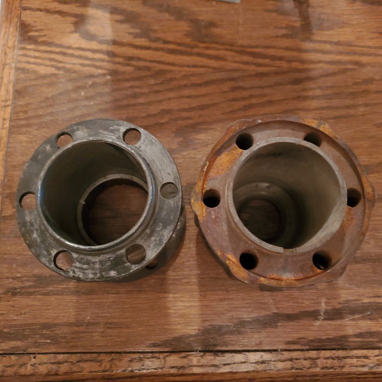

You can use the early closed spool if you grind the lip off around the edge. The center sections/housings are the same except the early ones had a recess for the lip to fit into. Using bolts and lock washers would be no different then the later ones that were setup that way, BUT the threads are no long the odd thread pitch like they were before. They now are a standard thread pitch so you would have to keep the bolts that are now installed, originals would no longer work.

I was just going to type just what Mark said about the closed spool lip. In your pictures it looks like the lip has been ground off the closed spool, this is a old time fix for mismatched parts.

I would get the open spool your 22 is supposed to have (20-27). A very common part. Not quite a dime a dozen, but pretty close.

If the step in the back of the spool has not been removed, I don't know how the thing was ever assembled, let alone having any where near the correct crown wheel and pinion mesh. Just start again with the correct open spool bearing housing.
As far as the bolts go, the originals are an odd thread. If yours are replacements, the housings may have been tapped out, or the bolts may be 10mm x 1.5 pitch. These are a very close match to the originals. I had to substitute short bolts to be able to fit a Moore Gearbox with 3:1 gears in my old buckboard, and 10mm x 1,5 pitch bolts wound in 9 turns before binding a little, and this was plenty enough for the job.

It is an early spool and it looks to be on a later axle housing and like said grinding off the lip makes that possible. Looking at your photo it looks off centered but it must be the casting that was larger on the driver's side making it look off centered. There is still a lip on the spool that centers it in the bore . Putting
it together by grinding the lip off would
not cause any problems and it would work just as well as the later spool.
If it is loose ,you can probably just slip the gasket back in and tighten it.

The rear axle needs to be pulled to find out exactly what is going on. The spool may be incorrect for the housings, but it's a pretty safe bet that you will find several other things wrong inside.

I agree with Stephen. If it really is off center, the gears will be misaligned which will cause wear. That could be the reason for the noises and it will not get better, only worse until it breaks completely. Unless you have auxiliary brakes, if it breaks you will lose your foot brake. It could also lock up, causing you to be stuck wherever it happens and not even be able to push the car.
So you need to pull things apart and rebuild. Also use the correct parts. If you continue to use that misaligned part, it could just happen again.
