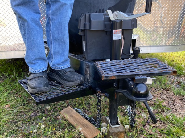

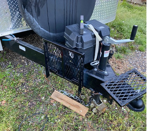

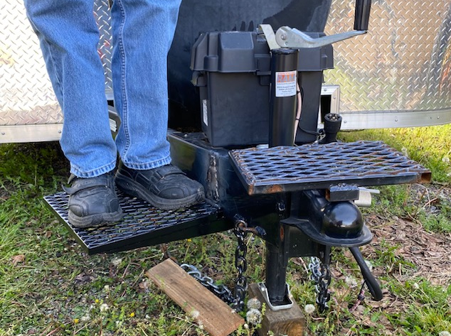

We have a F350 Ford Dually with a slide in camper. Behind the the truck, I tow our enclosed Model T trailer. My wife had a lot or trouble climbing into the camper, when the T trailer was on the truck, using a plastic stepping stool. I got out the welder, and using steel box tubing, some hinges, and expanded metal, I made two steps. Both are hinged, welded onto the trailer tongue,
And they work very well. I thought I would post these photos, in case someone else had a similar problem and wanted an idea on how to solve it.
