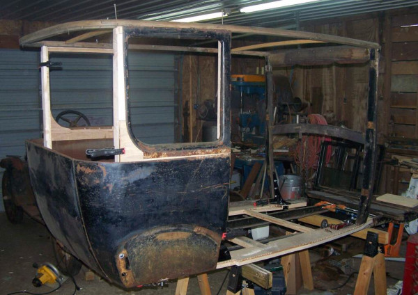

I took many photos with my cell phone during disassembly and failed to save them. I fell in the water cell phone and all and can’t retrieve them.
There is a wood spacer strip that goes somewhere between the cowl, dash, and windshield. Does anyone know where?

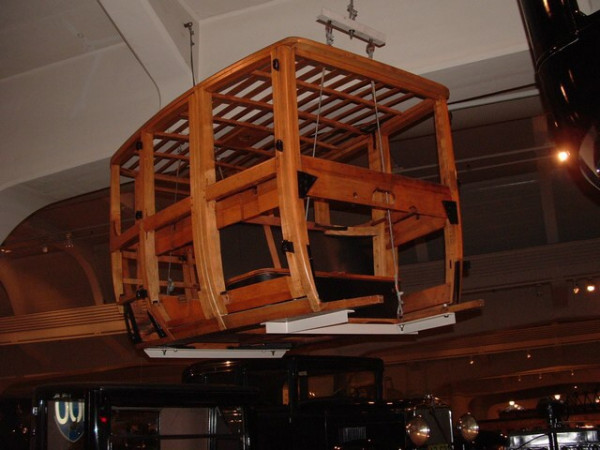

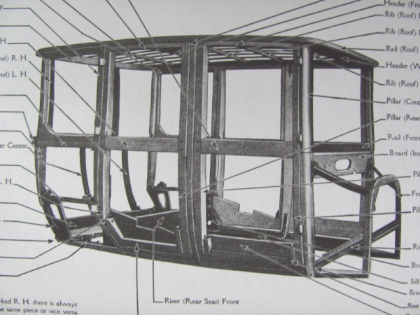

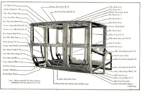

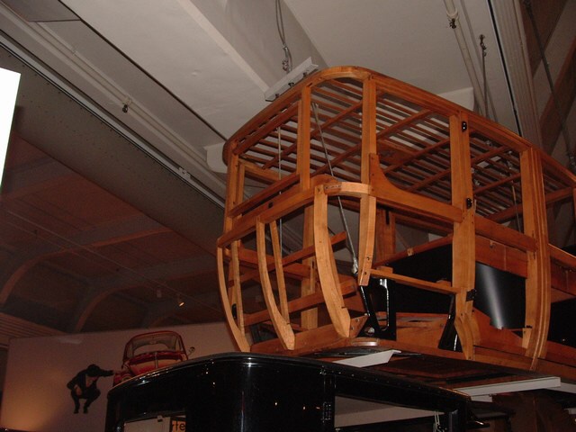

In answer to your question, the following photos and diagram might help...Jim Patrick

The pictures that Jim posted are the same ones I have so I'm no help there.
