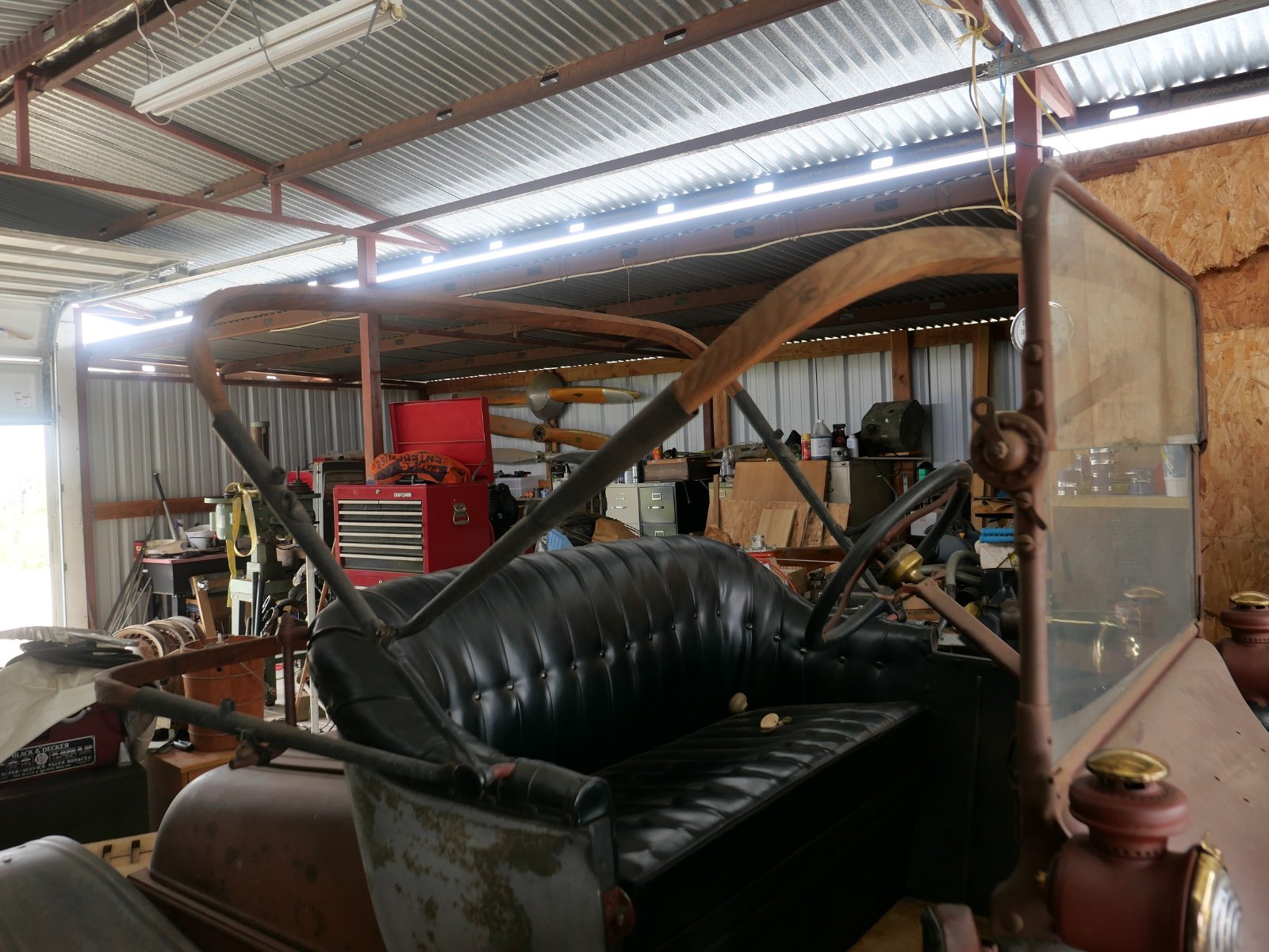

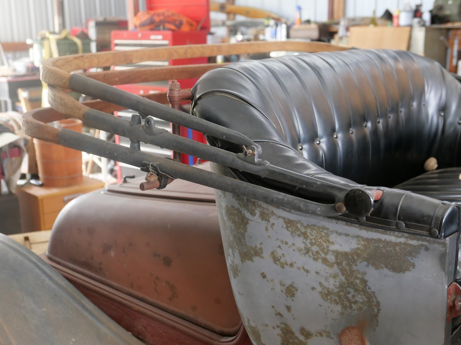

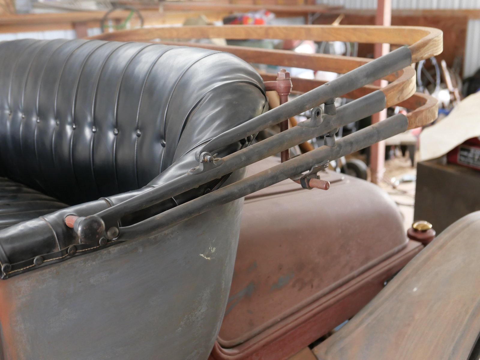

Some pictures of the top frame that came with my 15 Runabout.
Is it the right frame?
Do I have it on backwards?

The front bow comes out of the lower piviot and is moved to the higher piviot when in the up position. Reverse procedure to lower the top.

Thank you Jeff that's what I needed!!
