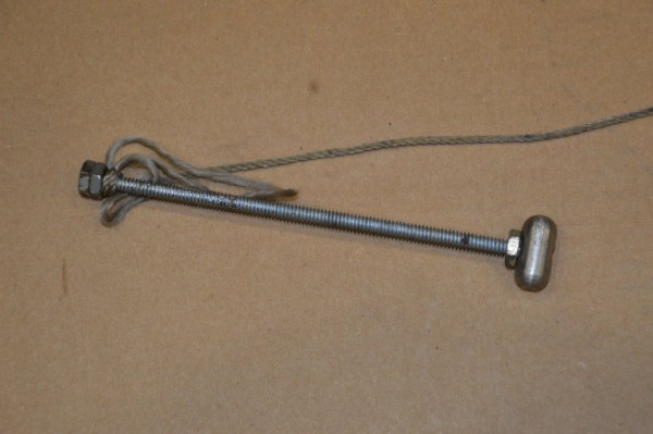

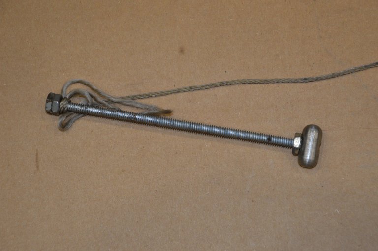

This is the 13/16 tool i use to adjust the clutch fingers.
