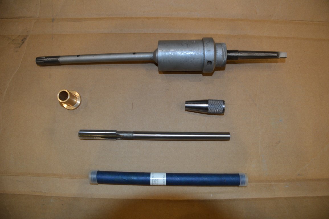

Re: spindle bushing reamer
If you ream the spindle bushings they need to be In line so I make a tapered sleeve to fit the bushing hole and slip over the shank of the reamer to center the reamer. I ream .0015 thousands under the finished size and run a roller burnisher through to make the material to finished size and it makes the material denser to hold up longer. I have never had to replace any bushings in the last 55 years.
