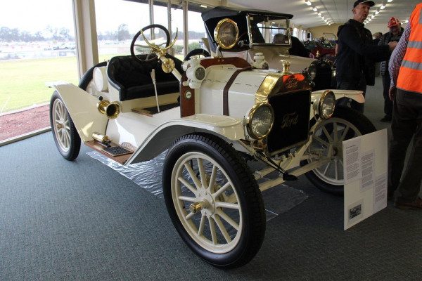

Hi all, Attached is the goal for Hay wagon to speedster project. It is not what I have right now.
A local carpenter is going to do the running board as a board. It will be multi-color wood clear coated with automotive clear. Should be great. I need some details though. In the picture it looks as though the end of the fender and the wood are simply stacked on top of one another on top of the hanger. Is that the way it goes? Also I am using 1 inch thick x 8.25 inch x 45 inch as the wood dimensions. Is that what it should be?

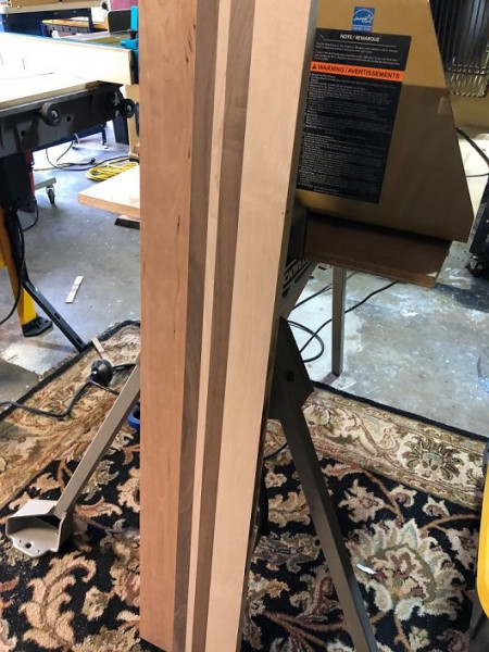

Here is a preliminary with a defect that is going to become a cutting board. It is 1 inch thick. He has them in 3/4 inch thick I am trying to decide which.
- Posts: 7273
Re: Acutal Board for Running Board End details?
19mm is standard these days, roughly 3/4". With the rubber/linoleum on top, the 1" alloy angle is a neat fit. If the timbers are hardwoods, 19mm is plenty strong enough over the short span on a T. Love the GT stripe!

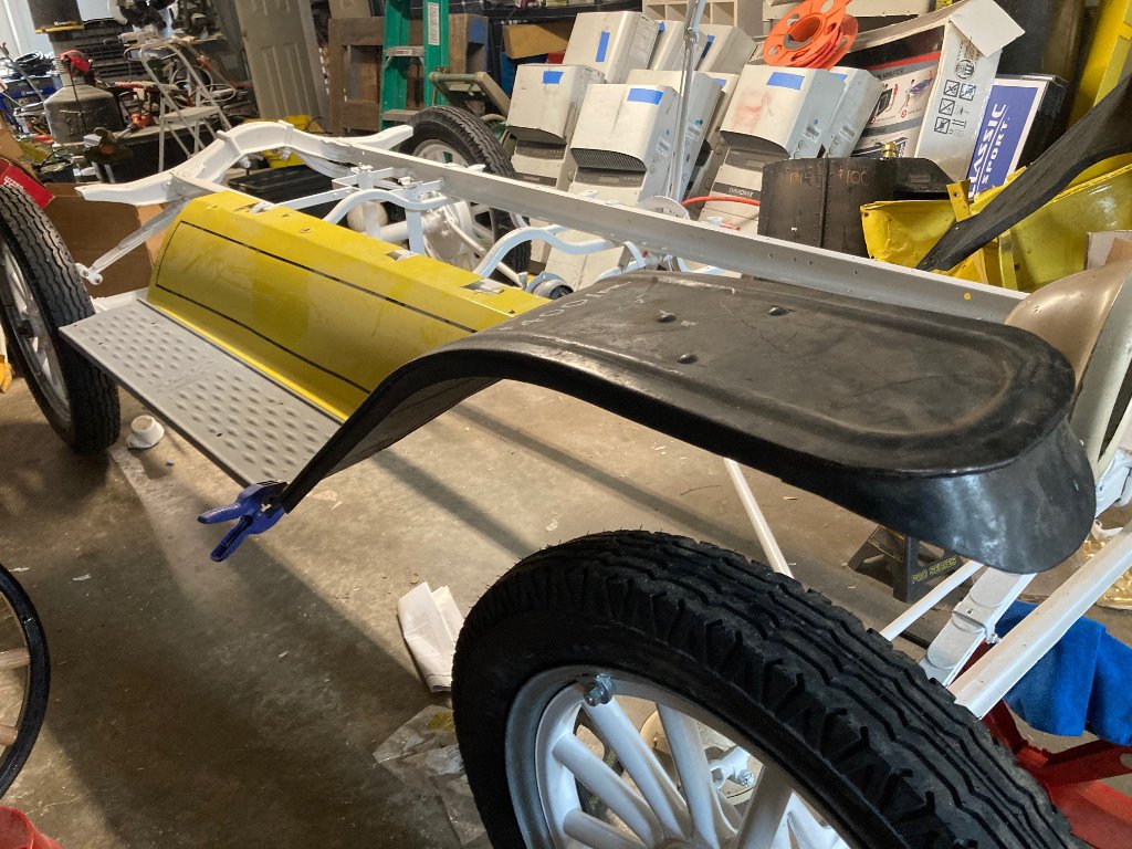

So I would need to slope the front edge of the board for the front fender since it would be a solid piece. I am wondering about the 3/4 inch because I measure the thickness of a steel one as being 1 inch so I would suspect that 3/4 inch would throw it off from the original? The photos show that the fenders attach to the bottom of the RB with the wood block in-between.
Ignacio,
Couple of things...
Depending year...some of the running board to fender tie ups did not have wood cleats, others did. With the wood, I believe it was always the center of the sandwich with the running board on top...
As to length, I think you may need to think some more. What are your front fenders, what are your rear? The photo you show of the inspirational white speedster just might have 16 or latter front renders turned backwards and swapped side to side. This would result is a shorter running board being required.
If you are using same year stuff as fenders go all the way around then the length would be the same as a standard Ford running board.
As to notching the lower corner of your wood...think it through. I seem to recall trying to use a set of repro blocks on a car not meant to take them...forget what year but probably later...I do think I had to belt sand away some of the block to get the proper 'lay-in'.
Couple of things...

I did a test fit of one side with a early running board, see picture. Superficially looked ok to me.
- Posts: 7273
Ignatio, you don't need any wooden blocks. The blocks go under the metal running boards and the fenders go under the blocks. Bolting the fenders directly to the underside of the wooden running board will give just the same alignment.

Agree. I think I will have to slope the front edge a little for the front fender. I think I am going to do the 3/4 inch thick. I re-measured and the interior of a running board to the edge is 3/4 inch and the wood blocks from Lang's are 3/4 inch. It is only the lip width that is 1 inch.
