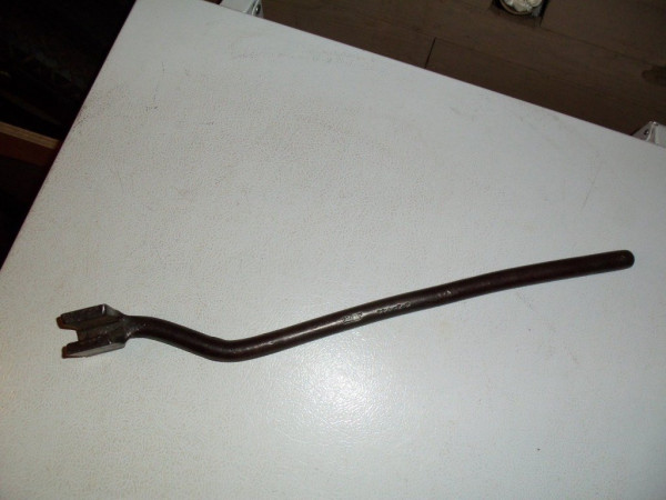

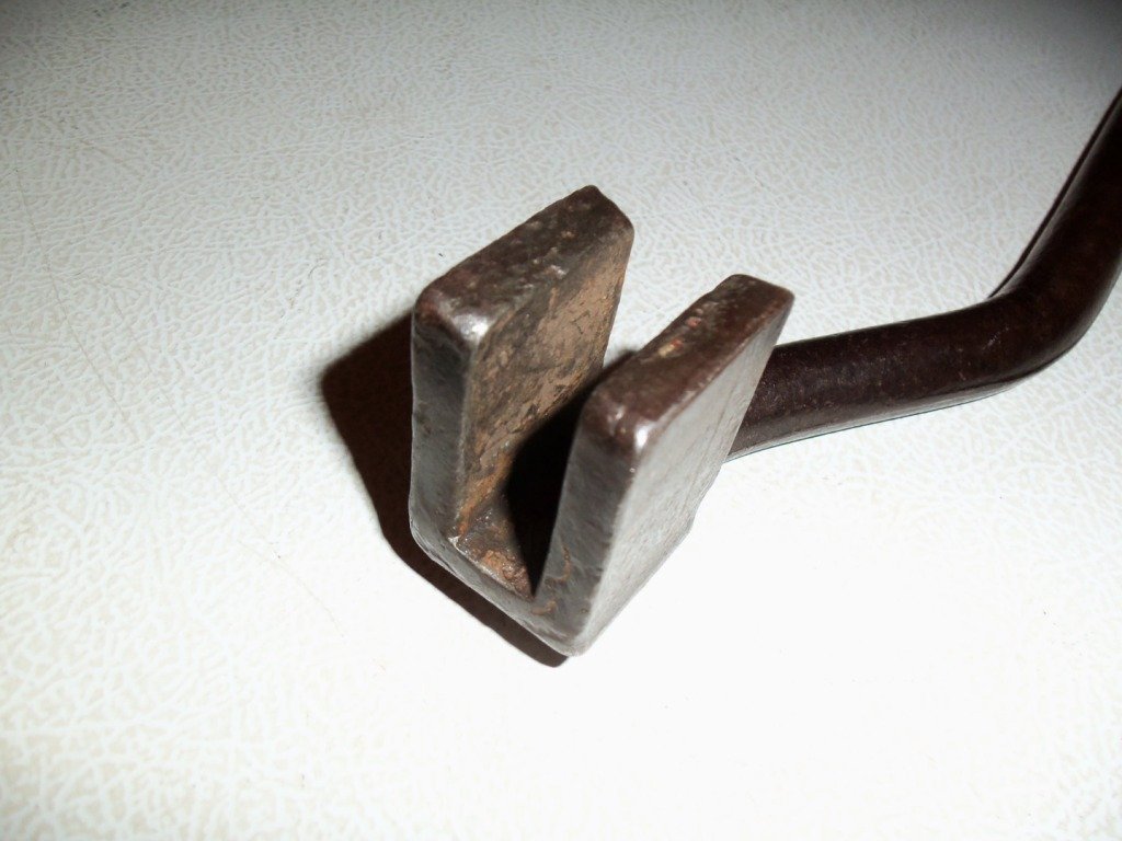

This is the Ford factory bending iron ! You can see the script & Z number.
I'd change out the floorboards !

That’s a tool that can easily be made. Or as some do use a large pipe wrench or a good sized adjustable crescent wrench.

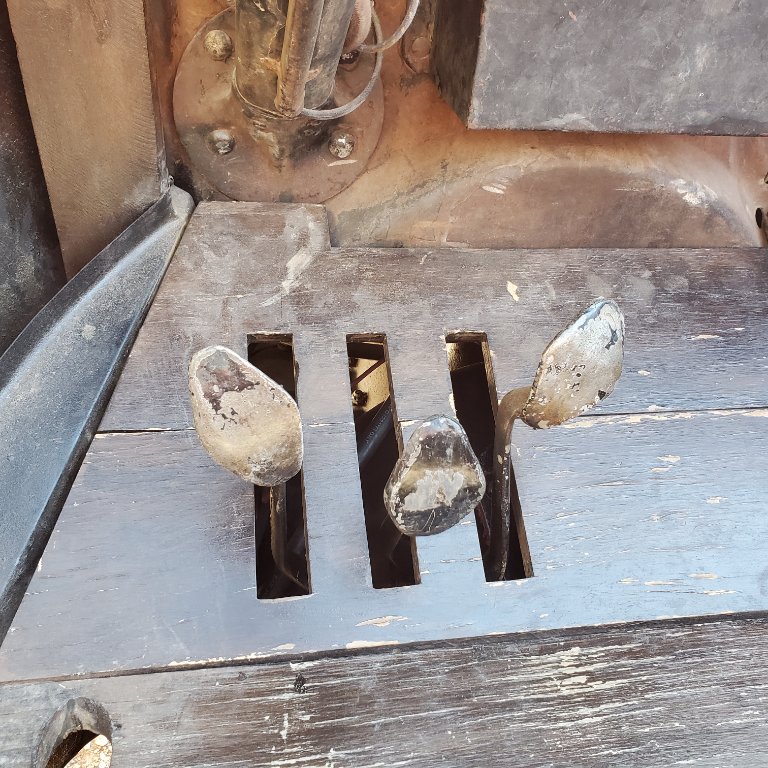

I bent my pedals out using a torch to better accommodate my 10 1/2 D

Sure could John - I just happen to collect original tooling for Ford Model T's !

Cool seeing the tool.... Haha 😄thanks

I will agree that you can easily change the floor boards. The 26/27 pedals are just better and safer, unmodified.

john warren that bend is a fantastic idea... I will do mine that way....thanks

No regret, and if someone wants to bend them back sometime in the future, they can.
Much, much better for me.

John Warren’s idea is a great one! With my large feet I have to remove my size 13 shoes to drive my T’s. This is how I learnt
that the pedals get real hot and I need the rubber pads!!
