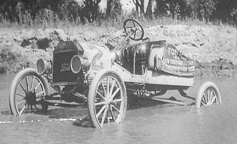

I would like to build a replica of the #2 Ford car that was in the 1909 race. I am looking for information on how the body was constructed. Does anyone have plans of pictures of the body construction it would be greatly appreciated. This picture is a replica of a car driven in the 2009 race/ jputnam(at)wcoil.com

Here’s an earlier post with lots of photos. Don’t know of drawings, several have built these, Richard Currier offers these bodies already crafted.
Jack, Should you want to build accurate, the axles on originals were ‘wide track’ 60”!
http://www.mtfca.com/discus/messages/11 ... 1278351670

I thank you all for your assistance. I am really curious about the construction of the area where the angled foot boards corner meets the firewall. In some of the photos it is a flat piece angled from the outside of the body to the firewall and in other photos it is rounded and curves into the firewall. Above all what is supporting the outer edges of the body? The outer edge of body is 5 inches+/- beyond the frame brackets. Too many questions yet to be answered. Thanks again to all.

Before you get started be sure an authenticate some of the versions that currently exist. There are many differences in the old photos of the original and the museum pieces. Seats, side lights, headlights, exhaust etc. Also there are pictures of #1 that could help as well
Previous thread about NO2 http://www.mtfca.com/discus/messages/11 ... 1278351670
